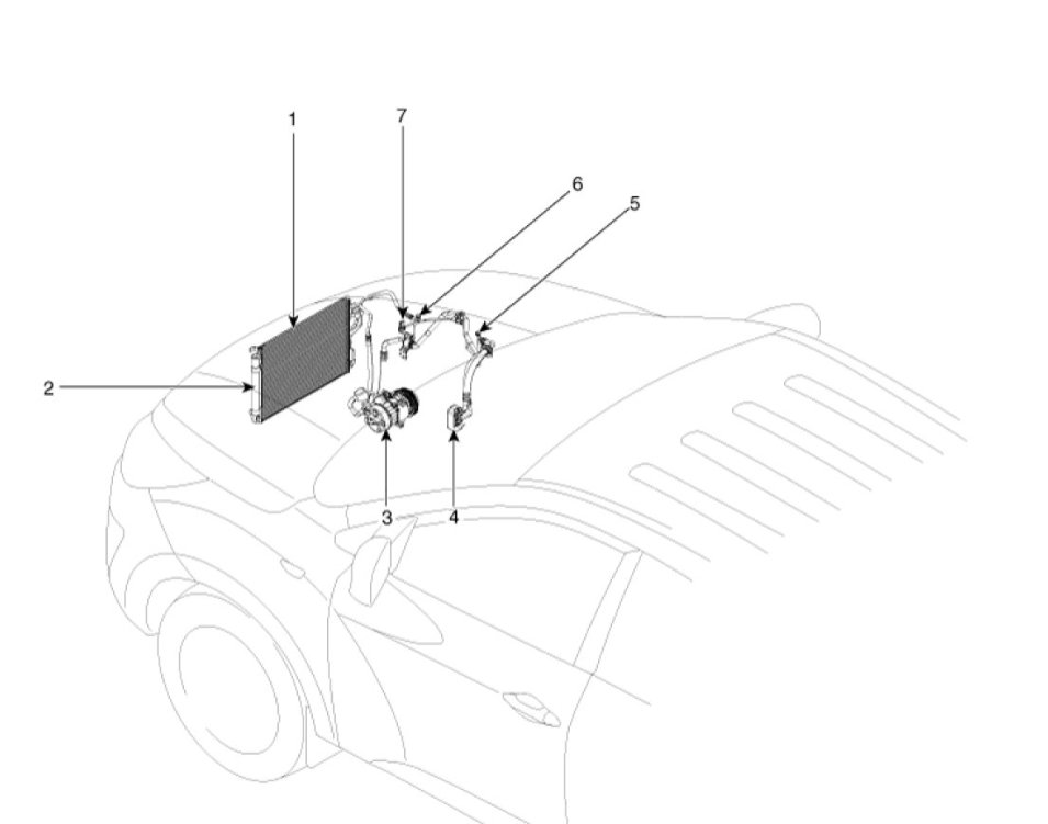

There is only one reason the low side hose will collapse is the expansion valve is plugged not allowing refrigerant to flow throughout the system. Please vacuum down the system to inspect the valve. Also, if the valve is plugged which it sounds like the compressor is coming apart and filling the system with debris.
https://www.2carpros.com/articles/replace-air-conditioner-compressor
and
You will need to flush the system as well as replacing the receiver dryer.

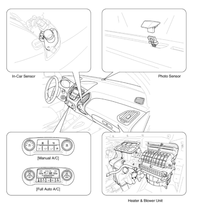

Here is the expansion valve #4 in the diagram. Check out the diagrams (below). Please let us know what happens.

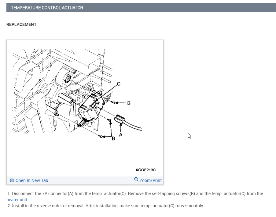

If the compressor is working, the suspect there is a problem with the blend air door actuator. This component allows cool air to enter the vehicle. If it is not working, you will get heat or ambient temperature air flow.
Here is a link that in general discusses the component and its replacement. Take a look and see if it helps.

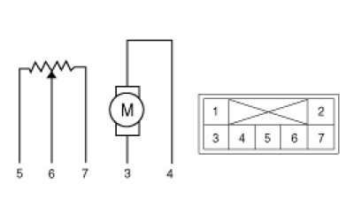

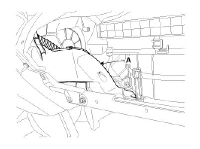

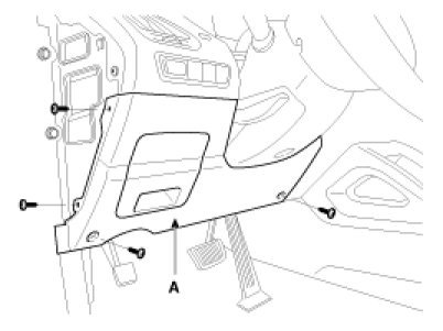

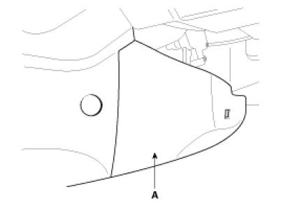

If you find the air door actuator (blend air door) is not working, here are the directions for both testing and replacement. All attached pictures correlate with these directions.
REPAIR PROCEDURES
Inspection
1. Ignition "OFF"

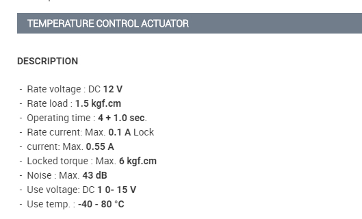

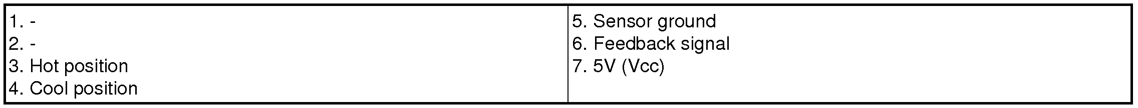

2. Disconnect the connector of temperature control actuator.
3. Verify that the temperature control actuator operates to the hot position when connecting 12V to the terminal 3 and grounding terminal 4.
Verify that the temperature control actuator operates to the cool position when connecting in the reverse.
[Drive]

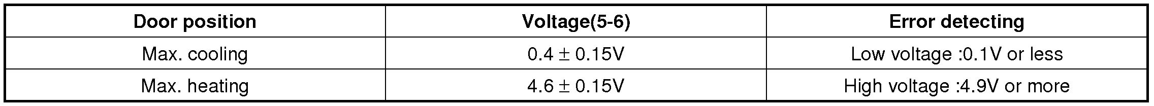

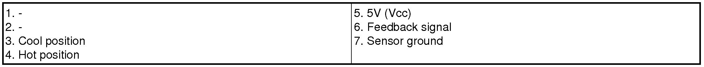

4. Check the voltage between terminals 5 and 6(Drive).
Specification
[Passenger]
5. Check the voltage between terminals 6 and 7(Passenger).
Specification
It will feedback current position of actuator to controls.
6. If the measured voltage is not specification, substitute with a known-good temperature control actuator and check for proper operation.
7. If the problem is corrected, replace the temperature control actuator.

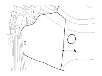

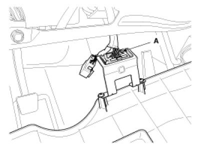

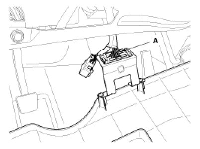

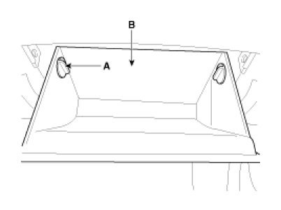

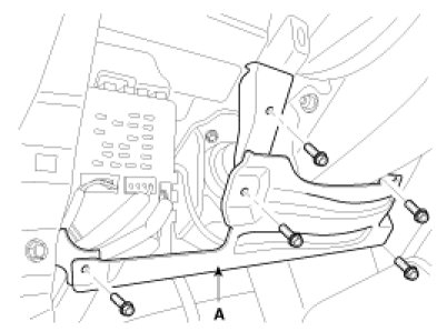

Replacement

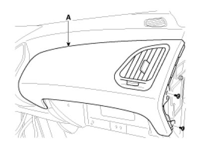

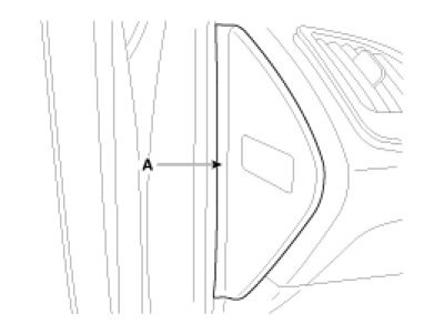

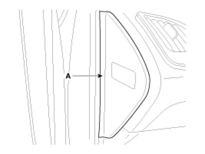

1. Disconnect the negative (-) battery terminal.

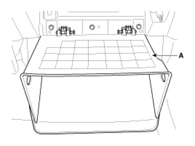

2. Remove the crash pad left side cover (A).
3. Remove the extension cover(A).
4. Remove the crash pad lower cover (A).

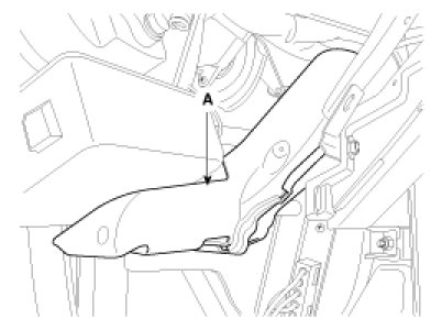

5. Disconnect the diagnosis connector (A).
6. Remove the reinforcing panel (A).
7. Remove the shower duct (A).

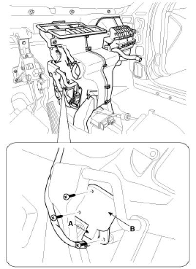

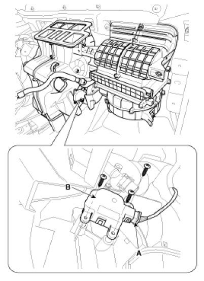

8. Disconnect the temperature control actuator connector (A).
9. Loosen the mounting screw and then remove the temperature control actuator (B).

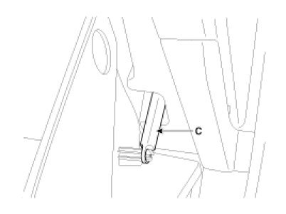

10. Remove the right extension cover (A).

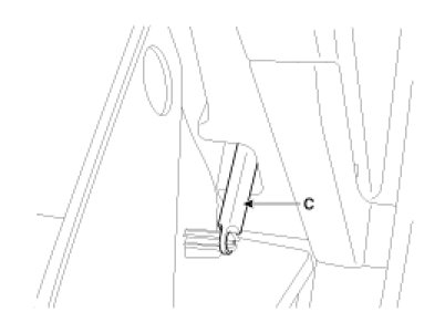

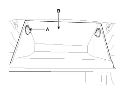

11. Disconnect the damper (A) from the glove box (B).
12. Remove the glove box lift (A).
13. Disconnect the pine (A), then remove the glove box (B).

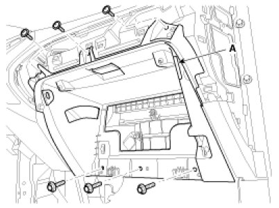

14. Remove the crash pad passenger panel(A).
15. Remove the glove box housing (A).
16. Remove the shower duct (A).
17. Disconnect the temperature control actuator connector (A)
18. Loosen the mounting screw and then remove the temperature control actuator (B).
19. Installation is the reverse order of removal.
I hope this helps. As you can see by the directions, most of the dashboard needs removed.
It is not a fun job. Let me know if you have other questions.
