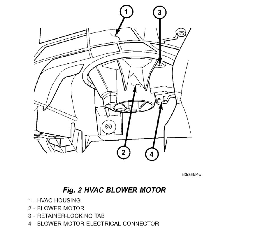

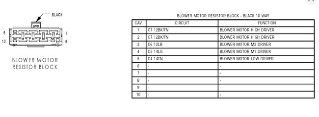

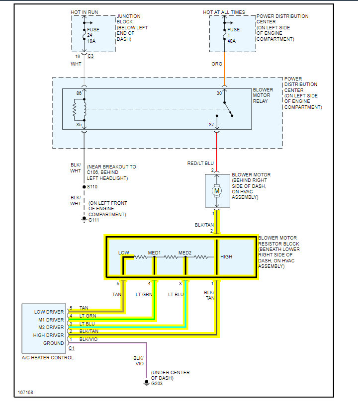

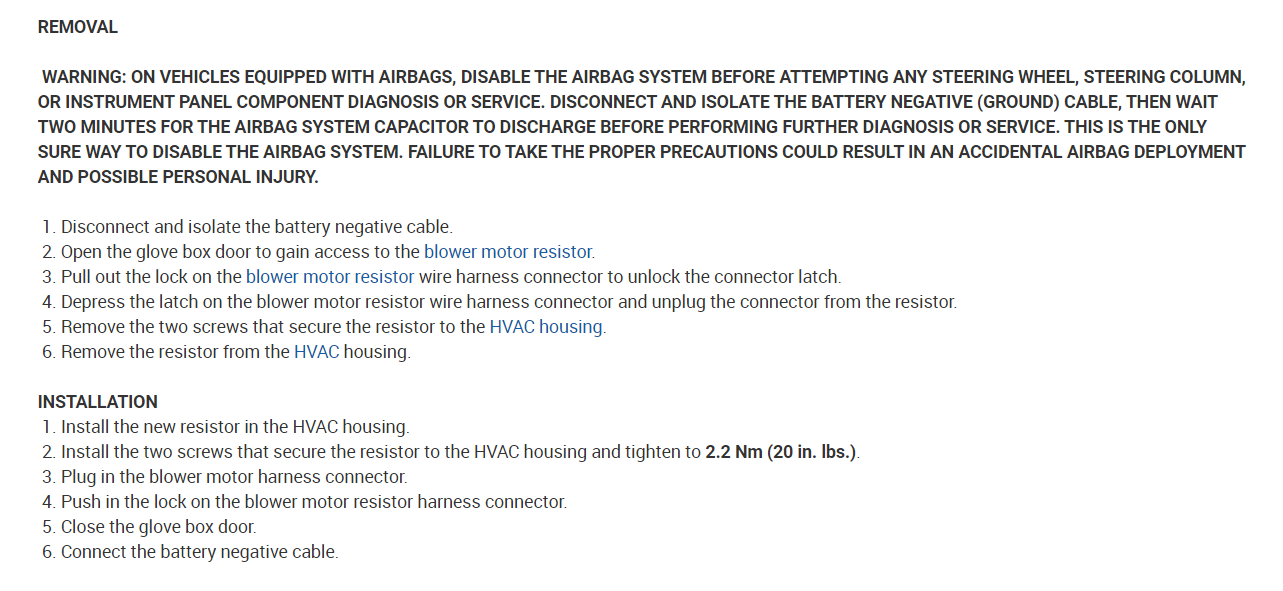

I went to a mechanic to get a quote for my climate control issue. My climate control has 4 levels 1-4 lowest to highest in level of cold air. It only hits level 4. One through three does not blow any air only til I put it on level 4. Okay so the mechanic said I have he has to order the blower system I googled it doesn't seem to be a thing. Can is possibly be the blower switch or resistor ??? I'm very confused ATM.any guiding would help. rn tia
