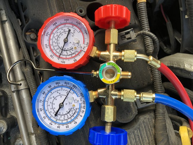

The gauges for the high and low both read 120 psi.
Thanks in advance for any insight!
Jul 3, 2019 at 6:23 PM
RICHARDINNC
  • 10 POSTS
This was with the car off and in about 90 degree weather.
Jul 3, 2019 at 6:27 PM

Same thing. No cold air though.
Jul 3, 2019 at 9:02 PM
Welcome back:
I'm sorry. I wasn't clear. What are the pressure readings when the system is running?
Joe.
Jul 3, 2019 at 9:47 PM
RICHARDINNC
  • 10 POSTS
They were the same.
Jul 4, 2019 at 8:21 AM
If the pressures were the same both static pressure, and with the system running, and the compressor clutch was engaged, the compressor is most likely the problem. If there is no change, it isn't working. You are certain that the clutch is engaging, correct?
Jul 4, 2019 at 6:38 PM
RICHARDINNC
  • 10 POSTS

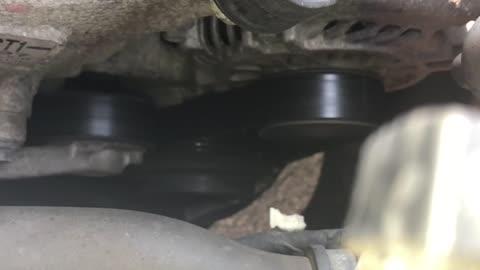

I took a video. I don’t know a whole lot but I think the clutch is engaging. The pressures on high and low are both 100 psi static and running. I just took this now in 89 degrees.
Jul 5, 2019 at 2:15 PM
Welcome back:
It's hard to tell in the video because of the angle I'm seeing it from. Try this. Have a helper in the vehicle with the AC off. Have the helper start the engine (AC off). While you are watching the compressor, have them turn the AC on. You should hear a click and the center of the pulley should start spinning.
Jul 5, 2019 at 5:24 PM
RICHARDINNC
  • 10 POSTS
Yes it clicks and starts spinning!
Jul 5, 2019 at 5:50 PM
Welcome back:
Since it is engaging and there is no change in pressure, the compressor is bad. I wish I had better news.

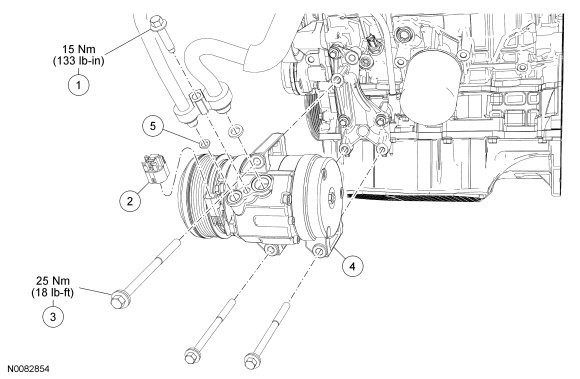

Here are the directions specific to your vehicle. The attached pictures correlate with the directions.
2012 Ford Fusion FWD V6-3.0L Flex Fuel
Air Conditioning (A/C) Compressor
Vehicle Heating and Air Conditioning Compressor HVAC Service and Repair Removal and Replacement Air Conditioning (A/C) Compressor
pic 1
NOTE: 3.0L shown, 3.5L similar.
pic 2
pic 3

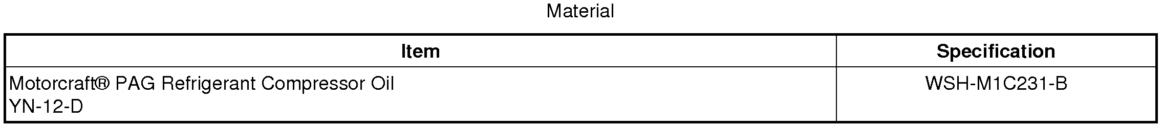

Removal and Installation
NOTICE: If installing a new Air Conditioning (A/C) compressor due to an internal failure of the old unit, the following procedures must be carried out to remove contamination from the A/C system. Failure to remove contamination from the A/C system, if present, will result in poor A/C performance and/or damage to the new A/C compressor and other components.
- If A/C flushing equipment is available, carry out flushing of the A/C system prior to installing a new A/C compressor.
- If A/C flushing equipment is not available, carry out filtering of the A/C system after a new A/C compressor has been installed.
- Install a new Thermostatic Expansion Valve (TXV), as directed by the A/C flushing or filtering procedure.
- Install a new receiver/drier cartridge as directed by the A/C flushing or filtering procedure.
NOTICE: Use only the Air Conditioning (A/C) refrigerant compressor oil specified for this vehicle configuration. Use of any A/C refrigerant compressor oil other than what is specified will contaminate and damage the A/C system.
NOTE: Installation of a new receiver/drier cartridge is not required when repairing the A/C system, except when there is physical evidence of contamination from a failed A/C compressor or damage to the receiver/drier cartridge. Damage to the receiver/drier cartridge includes physical damage or moisture contamination. Moisture contamination results only from a complete loss of refrigerant, and equalization of the refrigerant system pressure with atmospheric pressure for a period longer than one hour. If even a slight amount of positive refrigerant pressure is present in the refrigerant system before repairs are carried out, the receiver/drier cartridge does not need to be replaced.
All vehicles
1. If flushing of the A/C system has not been carried out, recover the refrigerant.
2. With the vehicle in NEUTRAL, position it on a hoist. For additional information, refer to Vehicle Jacking and Lifting. See: Vehicle Lifting > Procedures > Jacking and Lifting
3. Remove the lower engine splash shield (if equipped).
4. Remove the drive belt from the A/C compressor pulley.
5. Remove the A/C compressor manifold bolt.
- Discard the gasket seals.
- To install, tighten to 15 Nm (133 lb-in).
6. Disconnect the field coil electrical connector.
3.0L vehicles
7. Remove the 3 A/C compressor bolts.
- To install, tighten to 25 Nm (18 lb-ft).
3.5L vehicles
8. Remove the 2 A/C compressor bolts.

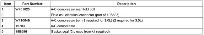

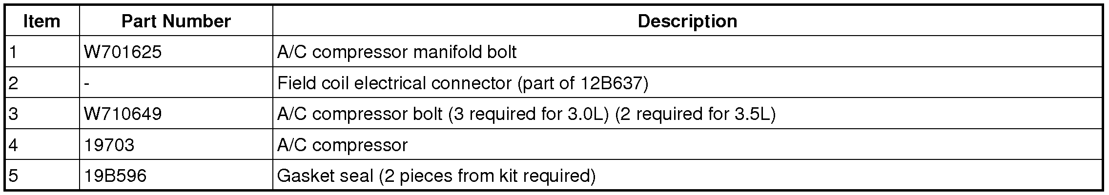

9. Remove the A/C compressor stud.
1. Remove the A/C compressor nut.
2. Remove the A/C compressor stud.
- To install, tighten the stud to 9 Nm (80 lb-in).
- To install, tighten the nut to 25 Nm (18 lb-ft).
pic 4
All vehicles
10. Remove the A/C compressor.
11. To install, reverse the removal procedure.
- Install new gasket seals.
- If filtering of the A/C system is not to be carried out, add the correct amount of clean PAG oil to the refrigerant system.
12. If filtering of the A/C system is not to be carried out, evacuate, leak test and charge the refrigerant system.
Let me know if this helps.
