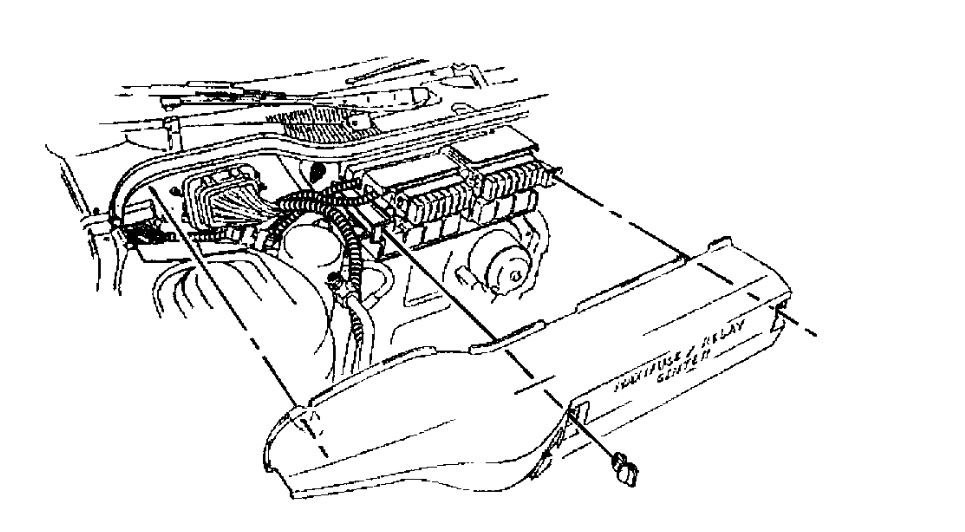

It sounds like you have a failed blower resistor. That is what controls the different speeds.
1. Disconnect the negative battery cable.
2. Remove the fuse block cover.
imageZoom/Print

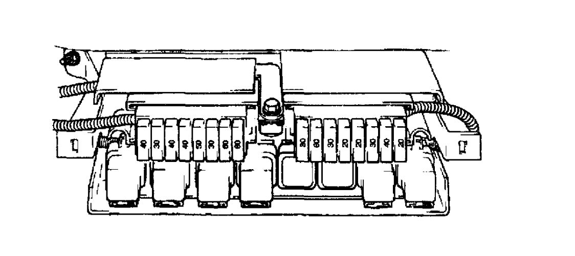

3. Remove the center bolt from the multi use relay and fuse bracket.
4. Remove the positive booster cable.
5. Disconnect the underhood fuse blocks from the bracket.
6. Disconnect the relays from the bracket.
7. Remove the nuts which attach the multi-use relay and fuse bracket to the front of the dash.
8. Remove the fuse bracket.

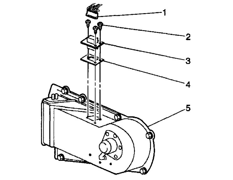

9. Disconnect the connector (1) from the blower resistor assembly (3).
10. Remove the screws (2) which retain the blower resistor to the heater and A/C module (5).
11. Remove the blower resistor and gasket.
