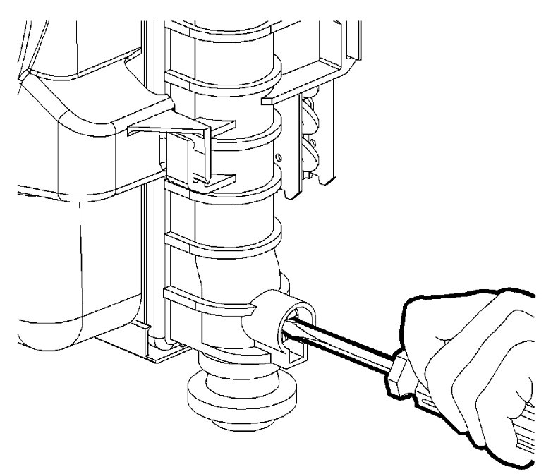

Can you send me a pic of where the radiator plug is located? the video doesn't let me see where is, I'm going to flush and fill my radiator but I can't find the plug.
Jul 15, 2024 at 9:34 PM
CANNON1349
  • 861 POSTS
According to the diagram, it looks like the drain is on the passenger side of the radiator and will require a flathead screwdriver type tool to unscrew out. I attached a photo from the repair procedure, nothing should be in the way of you getting the screw out.
Hope this helps,
William
Jul 16, 2024 at 7:30 PM

Is it on the drivers side??
Jul 18, 2024 at 6:51 PM
CANNON1349
  • 861 POSTS
There should be a protrusion from the radiator facing towards the wheel. Not towards the engine. From the diagram I have it looks like it may be on the passenger side.

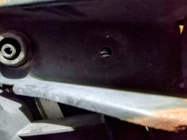

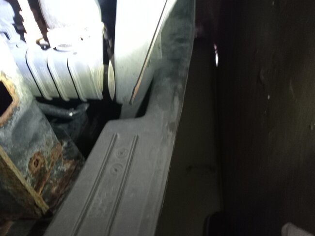

SHERILYN FRANKLIN
  • 90 POSTS
This is what mine looks like also a picture underneath it. It looks nothing like the pic you sent there is nothing on it where I can unscrew a plug.
Jul 21, 2024 at 10:01 PM
CANNON1349
  • 861 POSTS
Judging from the diagram the drain is on the side of the unit. It will require a tool to be put inside it so you may see a molded piece with an indentation.

What kind of tool??
Jul 23, 2024 at 9:22 AM
SHERILYN FRANKLIN
  • 90 POSTS
That second pic I showed you was the bottom not the side.
Jul 23, 2024 at 9:23 AM
CANNON1349
  • 861 POSTS
Yes, I saw that it was the bottom. Try looking on the sides of the radiator. You should be able to use a flathead screwdriver to turn the drain.
