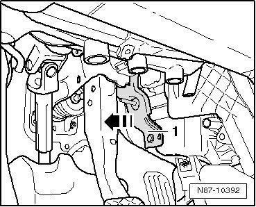

- Remove Data Bus On Board Diagnostic Interface (J533).
See pic 1
- Remove the bolts - 3 - (9 ± 1.3 Nm).
- The bolts - 1 - are not to be removed.
- Do not remove the bracket - 2 -.

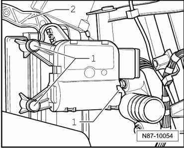

- Push the bracket toward the brake pedal - arrow - and fasten it there using a cable tie.
See pic 2

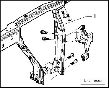

- Mark connector - C - to control motor (danger of interchange with other connectors of same construction).
See pic 3

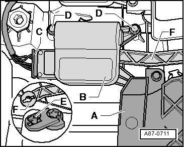

- Disconnect connector - C - on Left Temperature Door Motor (V158).
- Remove cover - A -.
- Remove bolts - D - (1.4 Nm) and remove Left Temperature Door Motor (V158) - B -.
- Disengage control motor lever - E - from connecting rod - F -.

- Loose the right support - 1 - from the assembly carrier.
See pic 4

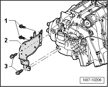

- Disconnect harness connector from Right Temperature Door Motor (V159).
See pic 5
- Remove securing bolts - 1 - and remove Right Temperature Door Motor (V159).
- Unhook brace - 2 - from Right Temperature Door Motor (V159).
