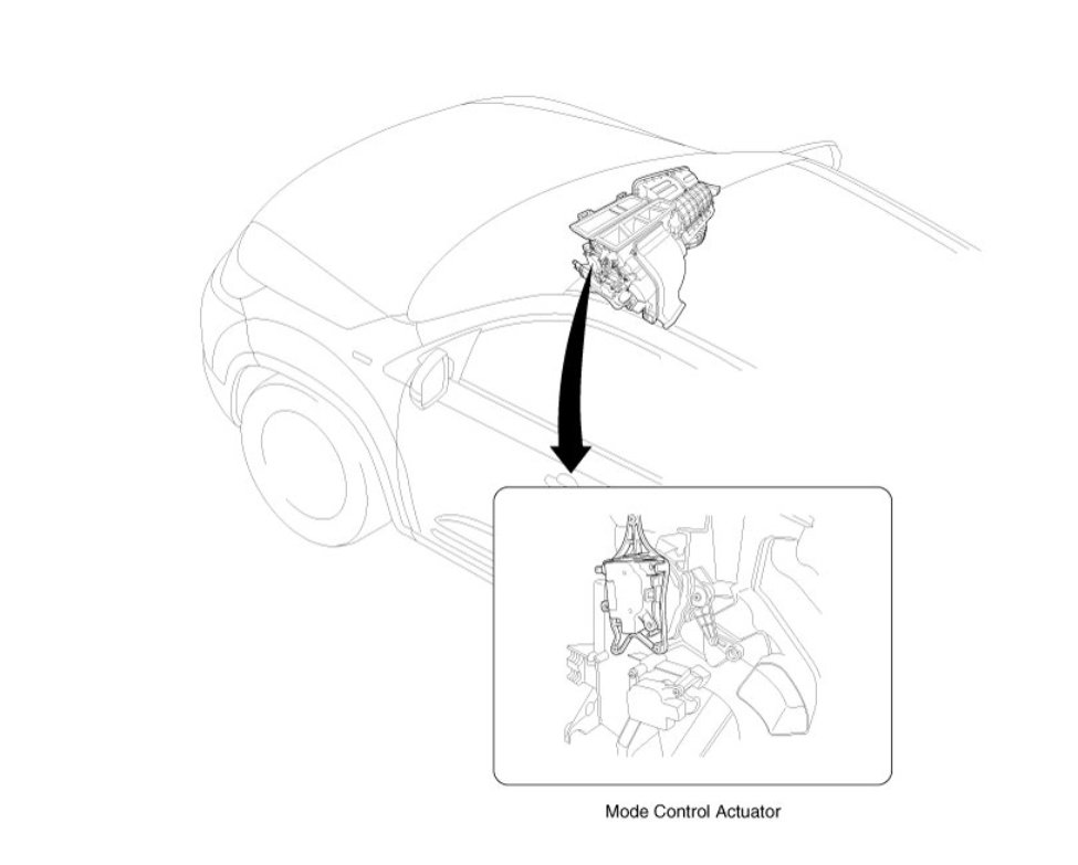

The A/C no longer blows from the front vents in the dash board. It only blows from the defrost vents. When you turn the air on nothing happens, but if you turn on the defrost air blows. What is this issue? Pep boys said the part that controls the air flow has gone bad. And it will cost $850.00 to fix. Is this true?
Thanks in advance!
Angell
Jun 21, 2017 at 4:16 PM
MHPAUTOS
  • 31,937 POSTS

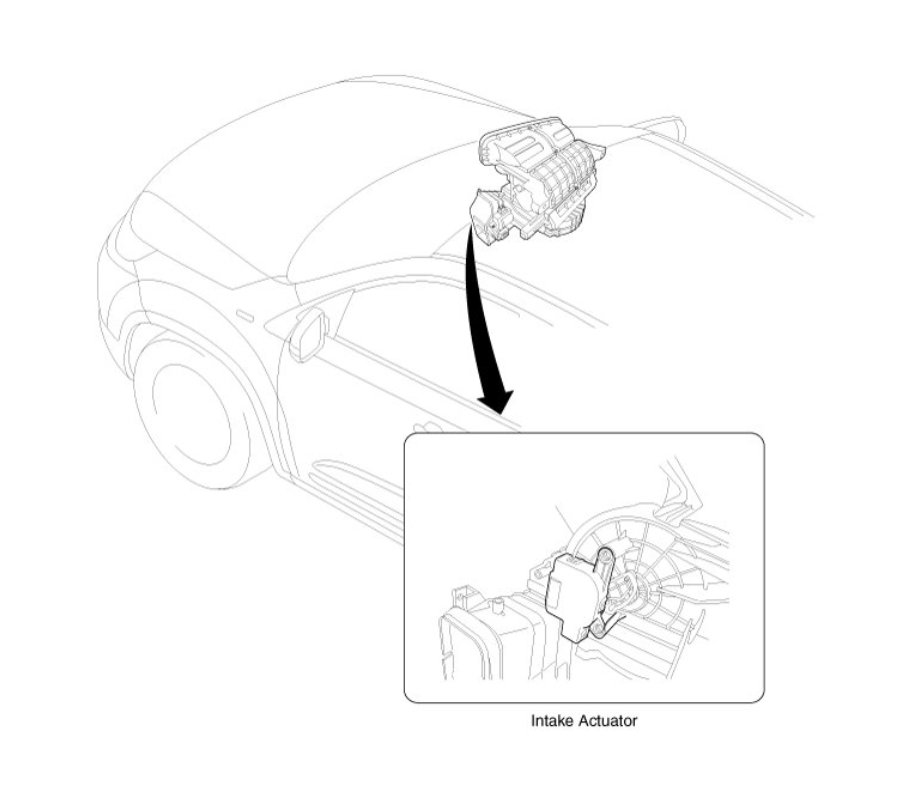

It sounds as if the mode blend door actuator is not working correctly the part codes about $80.00 here is the location of the blend door motor int eh diagrams below I have also included two guides to help fix the issue,
and
https://www.2carpros.com/articles/car-air-conditioner-not-working-or-is-weak
Check out the diagrams (Below) here are all locations of the blend door motors. Please let us know what you find.

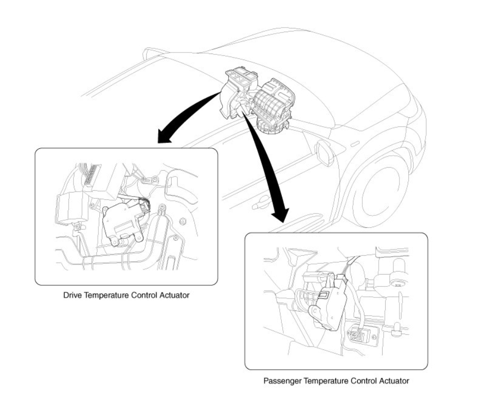

You have a temperature blend door actuator that is not working right. Here is a guide to show you what you are in for when doing the job:
Here is the location for your car. Check out the diagrams (below). Please let us know if you need anything else to get the problem fixed.

Yep, this fixed my car, thanks for the guide.
