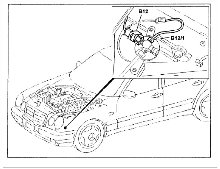

How would I test the refrigant pressure switch for this car without a handheld tester?
Jun 9, 2018 at 3:34 PM
You can test it using a test light. Here is a guide to help show you how:

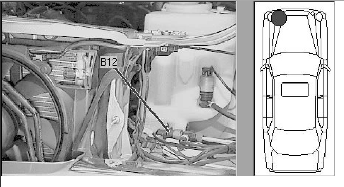

You can test for a ground or power connection through the sensor. Here is the location (below).
