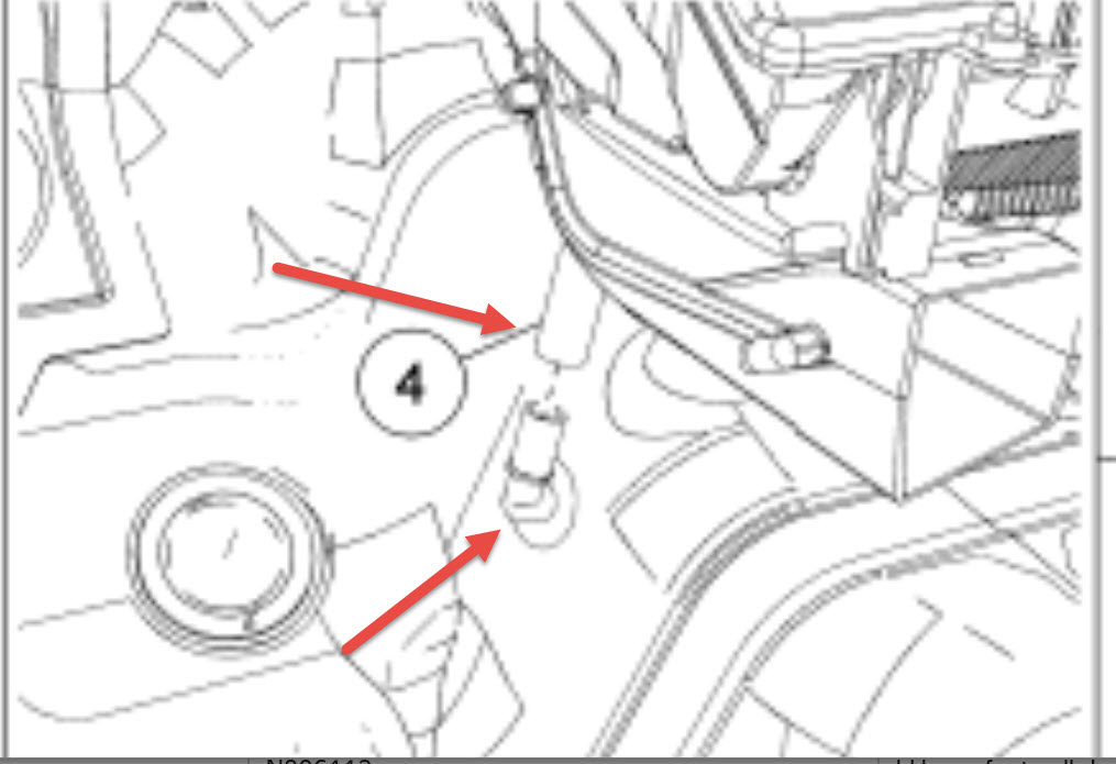

When I turn on air condition water leak on floor of passenger side. What should I do?

check from under car to see if drain line is plugged, run a piece of stiff wire through it and twirl it around to unclog it. See picture you wont hurt anything by doing this.
Image (Click to enlarge)

Thanks for reply. I was able to unclog the drain.
