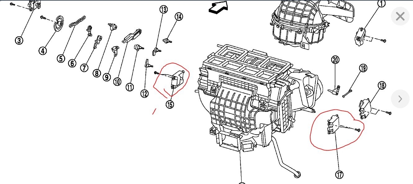

When you command heat and A/C can you hear the blend door moving in the dash?
