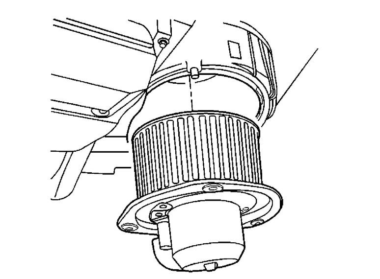

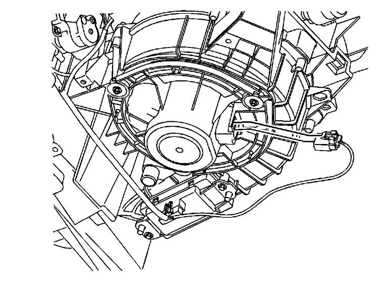

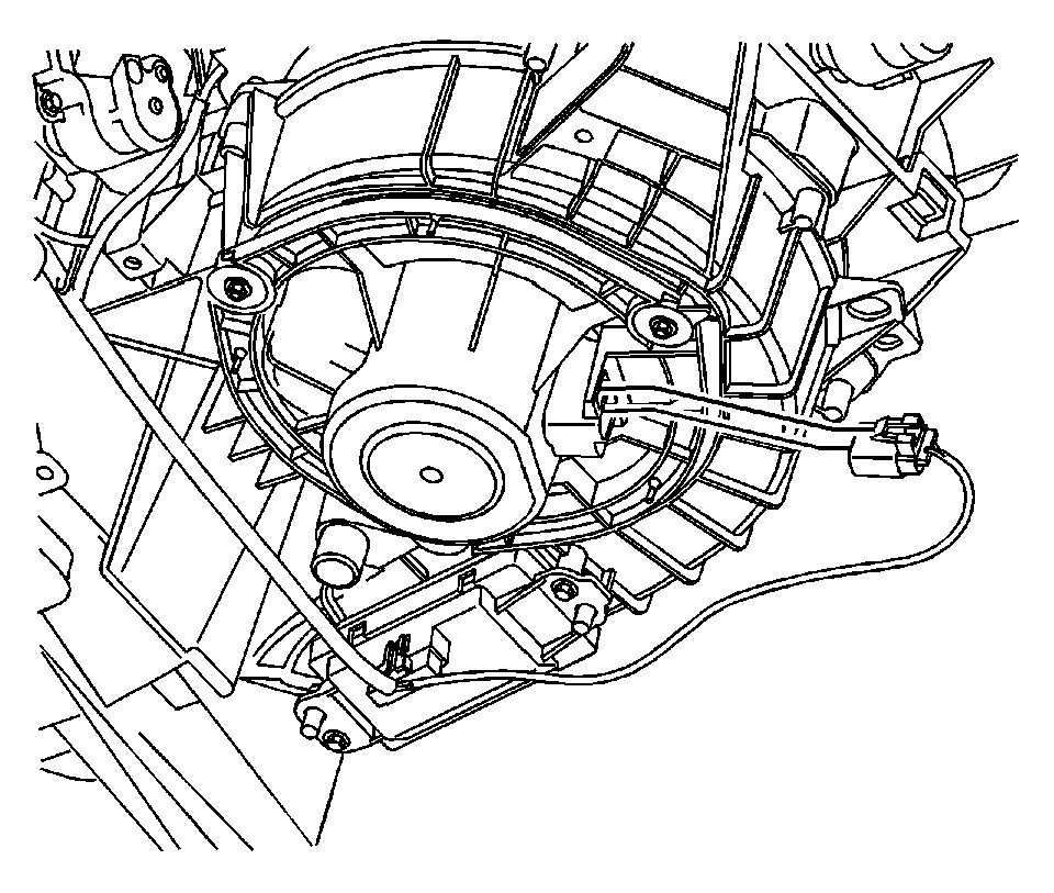

To remove the blower motor is very easy to do on your car. If you go under the dash on the passenger side you will find a panel that has a few screws and push pin fasteners. Remove it and directly above it is the blower motor. It has an electrical connector and three screws that hold it in place. Remove the connector and the screws and lower it out of the HVAC box.
If you find nothing obvious like fuzz/water/a mouse or?? Then it is likely the bearings are the problem.
