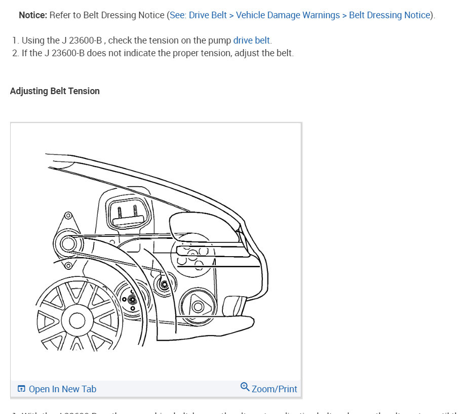

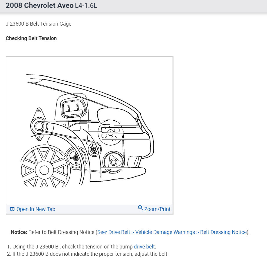

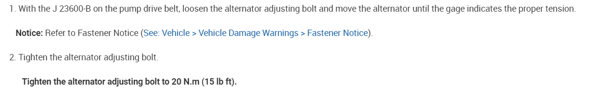

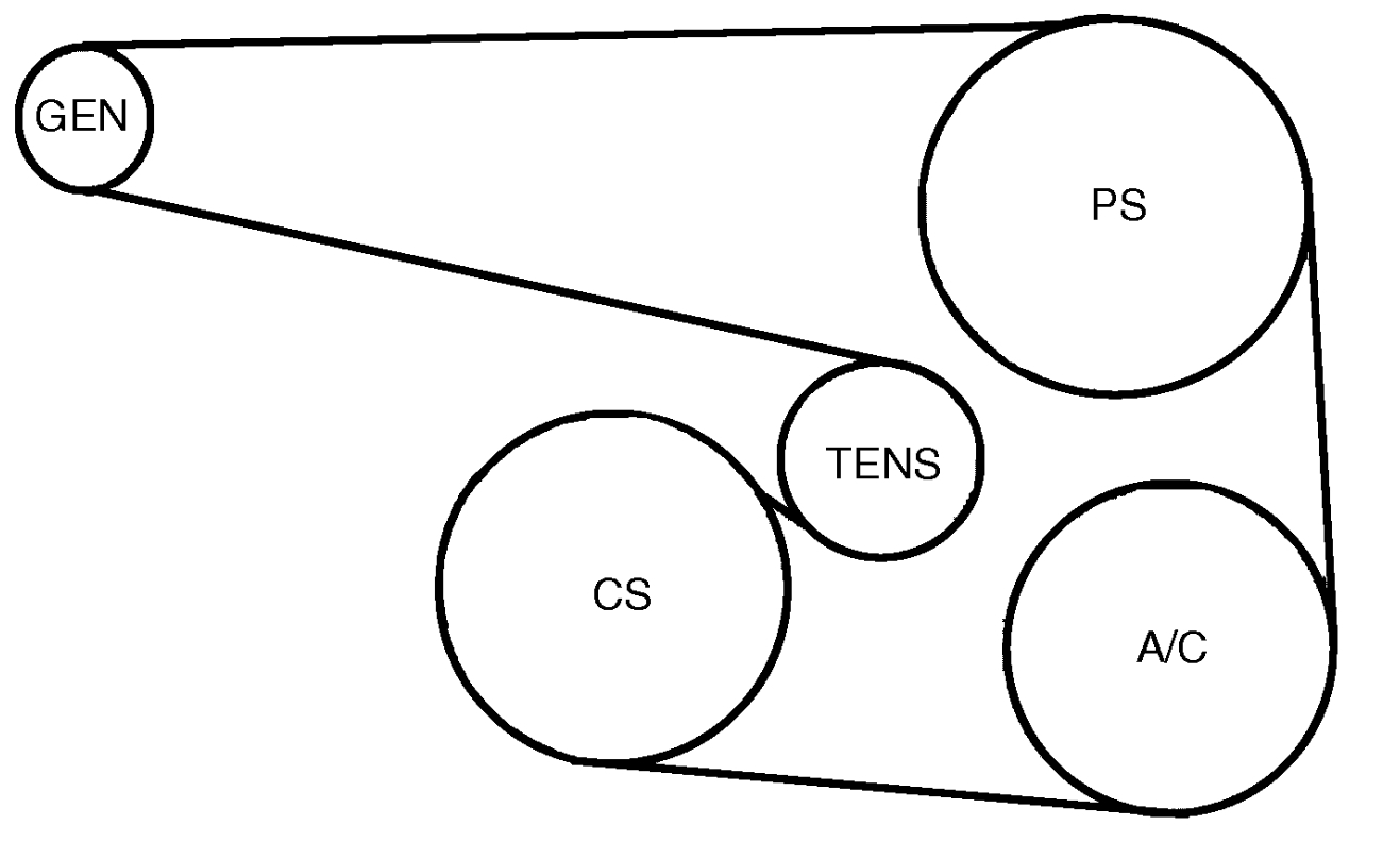

Thank you and yes, i see that it will be close, but i can't find a pulley anywhere that will work for this car as a dummy pulley for A/C unit. My A/C works good, but it keeps snapping the belt soon as we put a new one on. My husband said that the A/C pulley is wobbly so that’s why I keep snapping the belt. I wish there was another way to fix this without having to replace the whole A/C unit, but I don’t know how other than putting the dummy pulley, but then I won’t have an air conditioner come next summer. I’m just trying to get it fixed right now so I can drive it because it is my only transportation for now and I have to go to town pretty much daily for my mother who is on hospice, but has chosen to be at home while she passes. so, see this is a big issue for me just trying to get this car mobile again. I will let you know how it works out and what I have to do when I can. Thanks again
