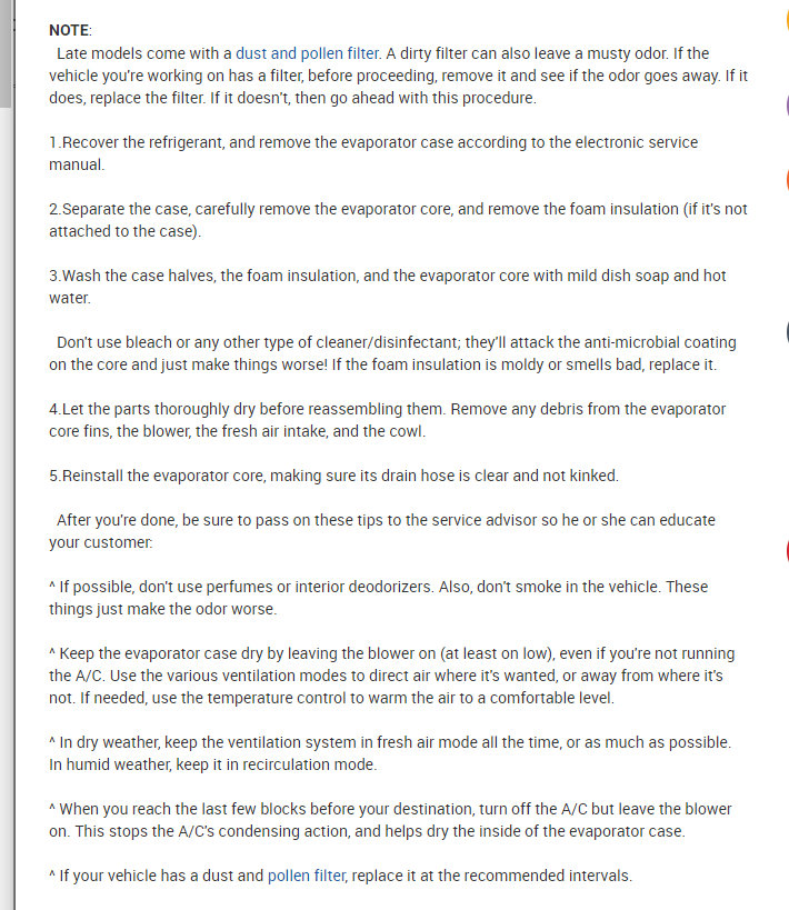

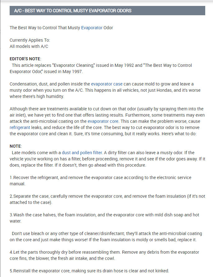

I have a musty smell coming from the AC/heat and I'm told that North American Civics (2000) don't come with a air cabin filter as opposed to European models which do. Why did they do that and how do I treat the musty smell?
