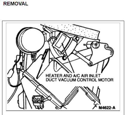

When i turn on my fans the motor is blowing, i get heat and cold but little fan strength on high. When i adjust the speeds i can hear it working and adjusting but same results. Blower fan is working. When took the fan motor out i tested the motor was blowing perfectly and afterwards i can see the flap leading to the outside is closed. But when i put the fan directional on "off" then the flap opens. Put the directional on anything else and the flap closes. There is no in cabin air filter for the car.
