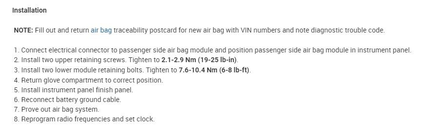

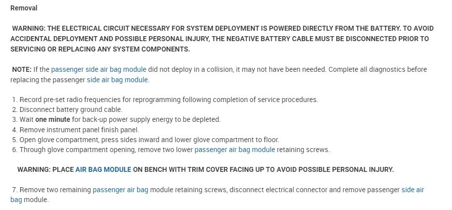

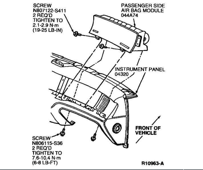

What is the procedure to remove the passenger side airbag assembly? Thanks, Bruce
Feb 5, 2020 at 5:45 AM
Good morning,
I attached the procedure below for you to remove the airbag. Here is a generic guide to help you step by step with instructions in the diagrams below to show you how on your car.
https://www.2carpros.com/articles/air-bag-removal-steering-wheel
Make sure you remove the negative battery cable and wait about 10 minutes. Check out the images (below). Please let us know what happens.
