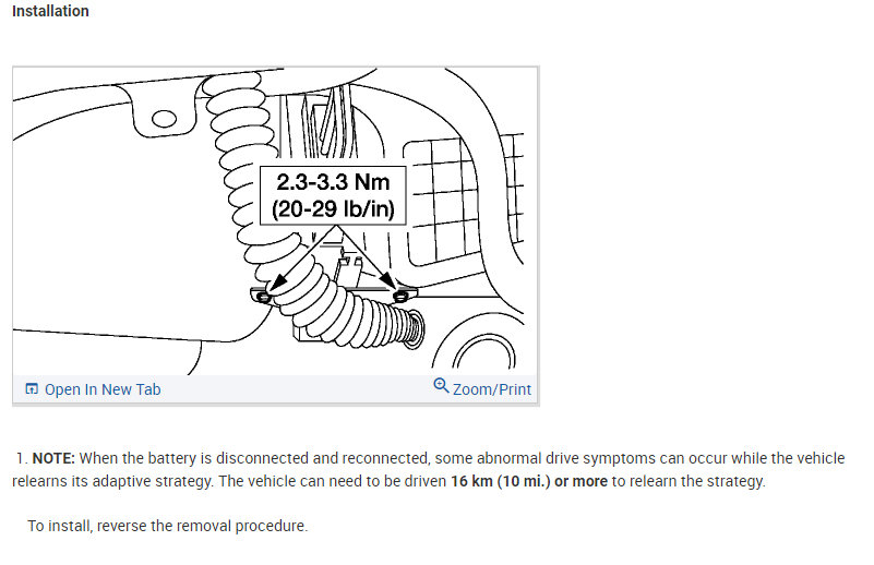

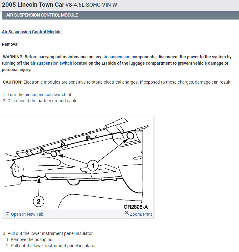

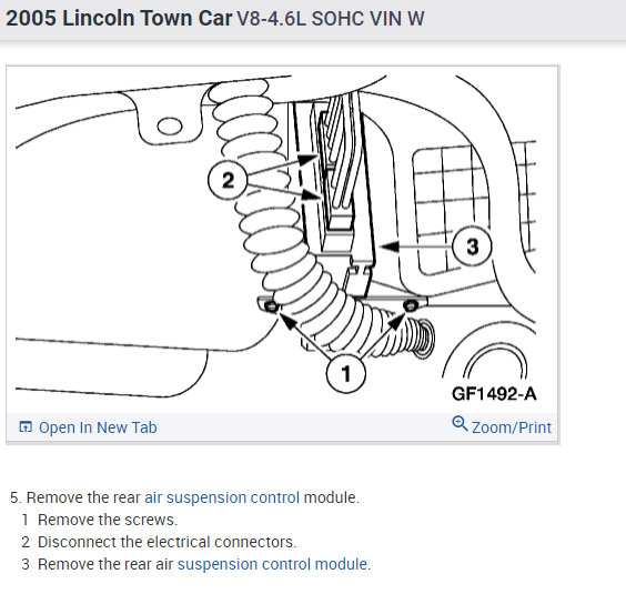

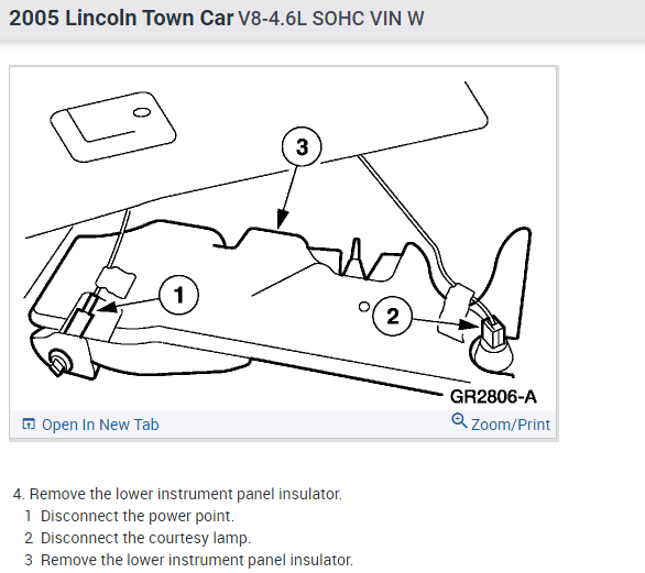

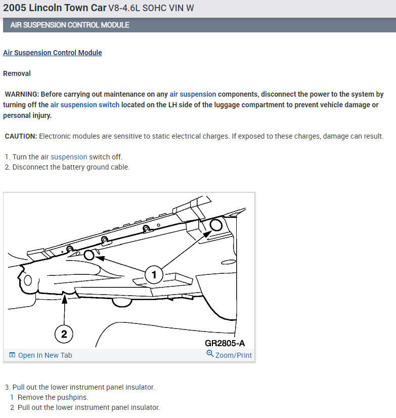

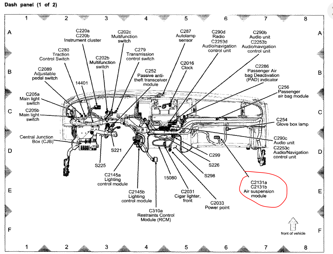

That control module is located under the passenger side dash (see diagram below).

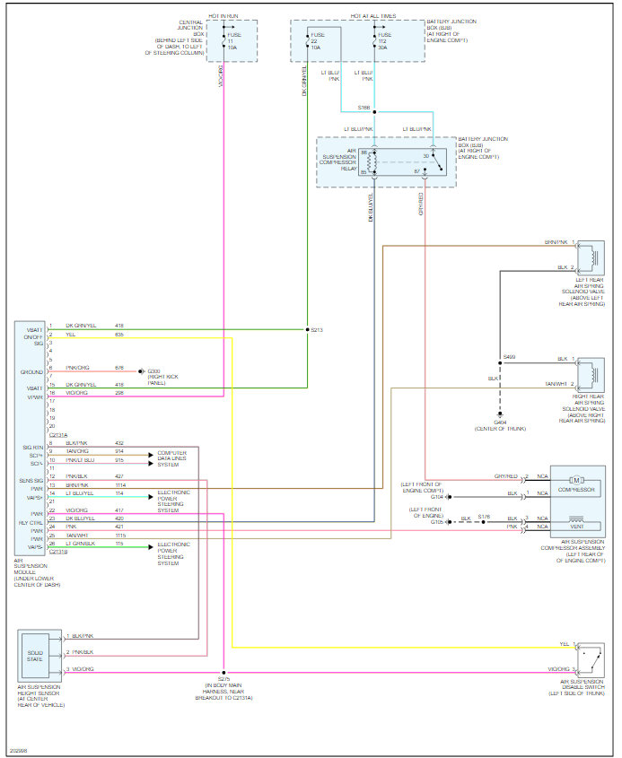

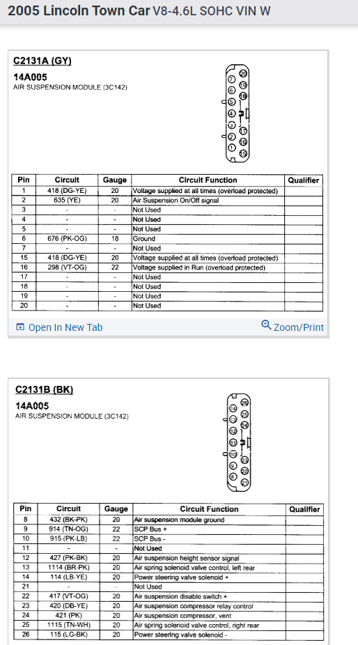

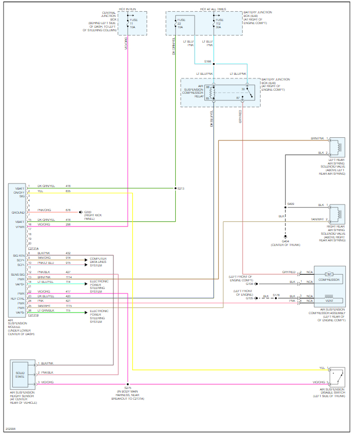

It can also be a wiring issue with the control module. I have attached wiring schematics.

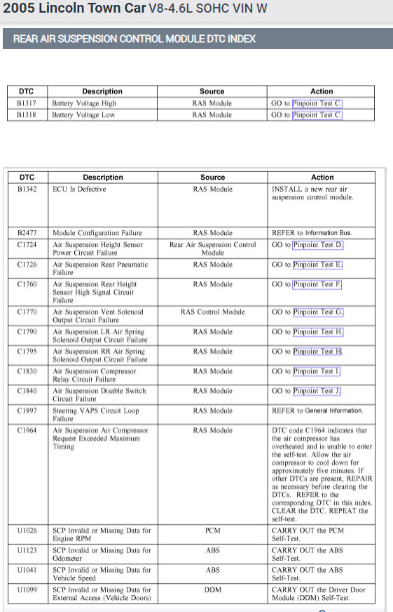

If you can scan the suspension fault code as it can point to exactly what is the issue might be with the control module.
