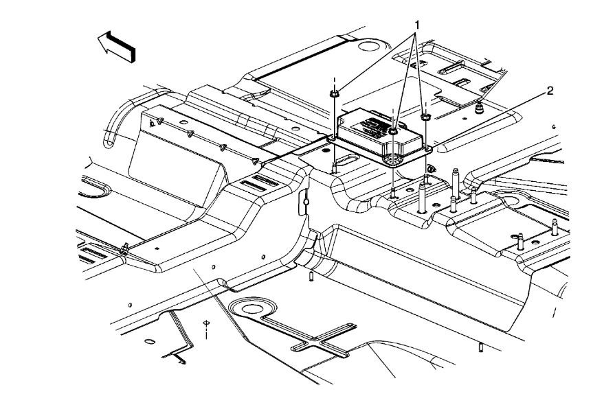

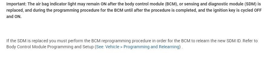

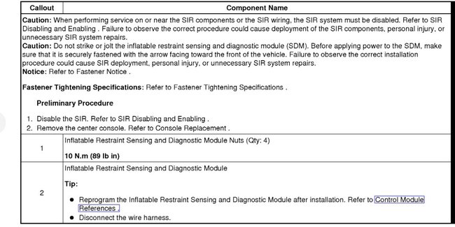

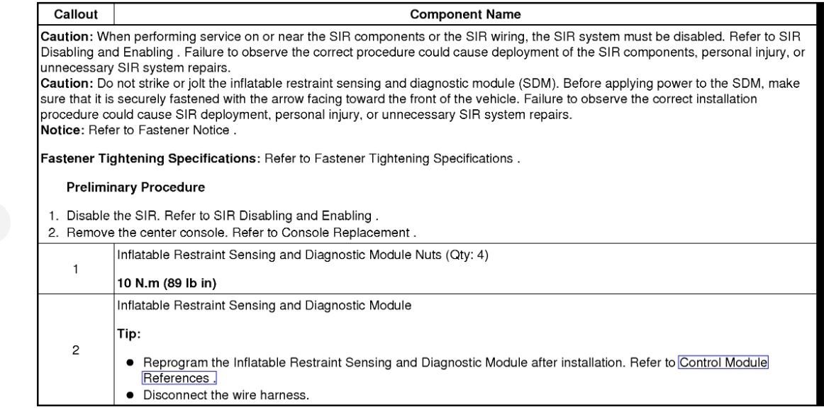

Good evening,
It is located under the seat. I attached a picture and the procedure.
The module must be programmed after it is installed. That will require special equipment to perform this operation before the system will come back online.
