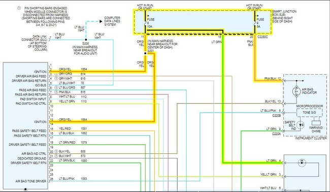

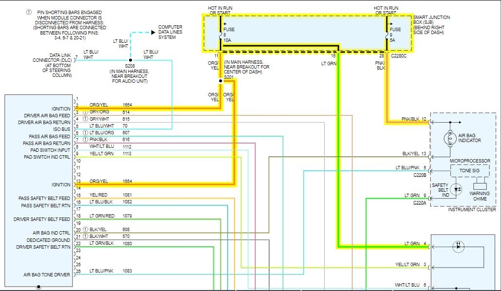

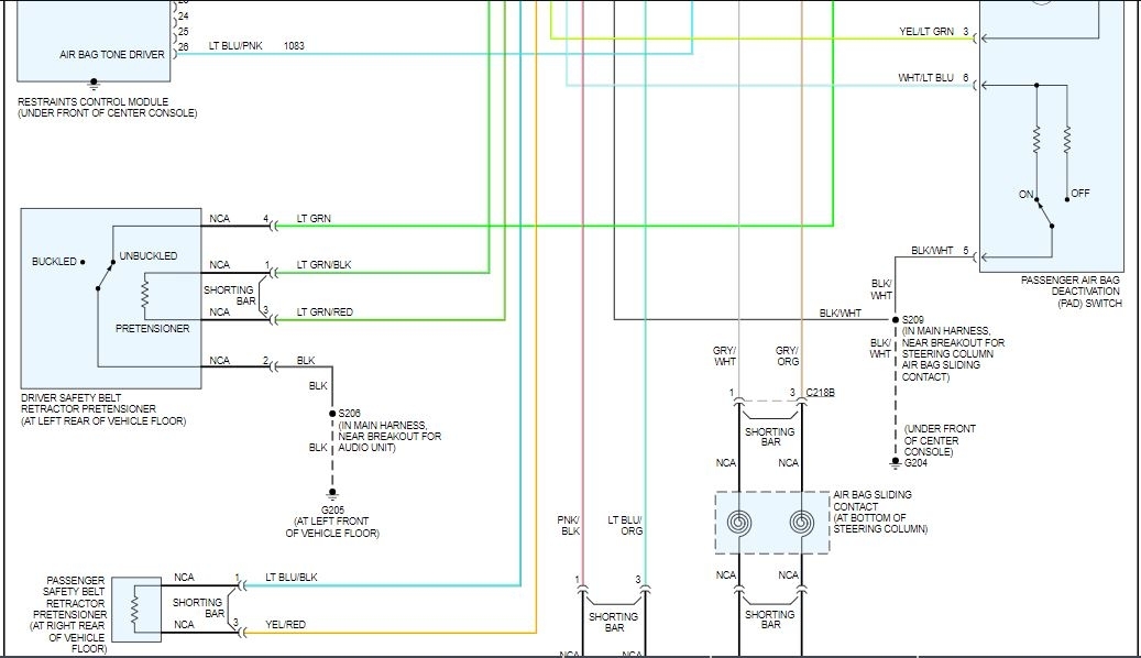

I attached a wiring diagram of the airbag system for you to view.
