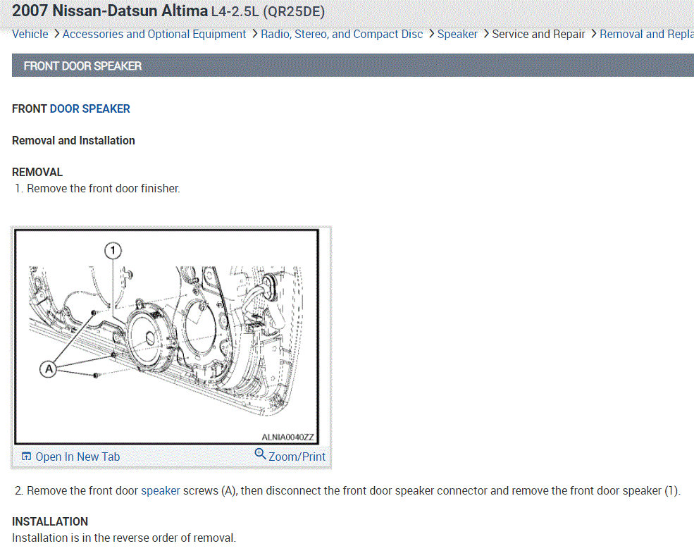

The pic below shows the replacement directions specific to this vehicle. Take a look through them and let me know if you have questions.
See pic below

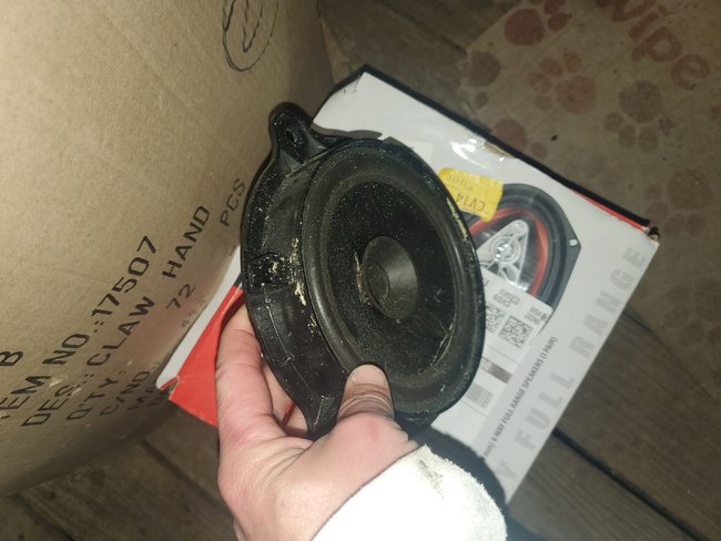

Yes, the speakers are the same size. i assumed you had to get an adapter because the old speakers are already connected to an adapter.
Apr 1, 2021 at 8:38 PM
Are you able to reuse the original adapters? That should take care of the problem unless the new speakers are thicker.
