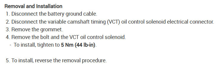

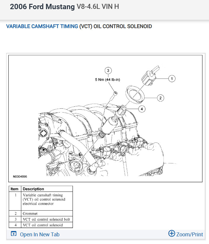

The P0011 code is the troublesome one. This can be the timing chain is off one tooth, or the camshaft actuator or oil control valve needs to be replaced, I would try the oil control valve because if is it stuck open it will over advance the camshaft. Here is the location of the valve so you can check it out, clear the codes once completed.
P0011 - "Camshaft Position A - Timing Over-Advanced or System Performance (Bank 1)"
P0171 & P0174 - "System Too Lean (Bank 1 & Bank 2)"
You want to replace the variable camshaft timing control valve on the passenger's side (bank A) Check out the images (below). Let us know how it goes.
