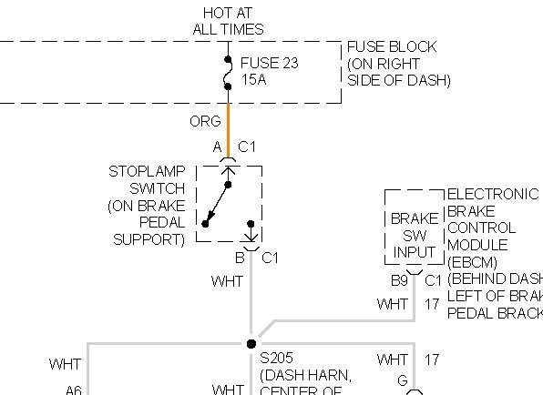

Did you check for voltage to and from the brake switch? Use a test lite. The orange wire is hot all the time, fuse protected. The white wire goes hot when brake switch is activated.
