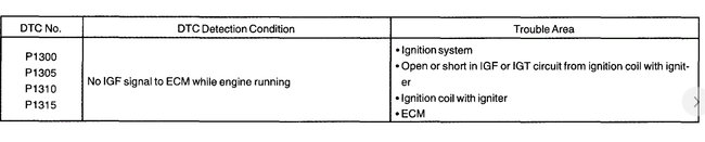

None of the codes are related to the MAF sensor. As you already know, the P0420 is the catalytic converter. The 130 an d 133 are related to the oxygen sensors. However, I feel the real issue is the 1300, 1310, and 1315. They are are codes for the ignition coils. See pic 1.
On the coils, there is what is called an IGT and an IGF signal wire. The IGT signal is from the ECM (computer module) which causes the coil (igniter) to create spark to the plugs. The IGF signal is basically the coil saying back to the ECM that a spark has occurred.
The first thing I need you to check are the connections at the new coils. Make sure they are tight, clean (not corroded) and not damaged.
Also, if the cylinders are not firing and sending raw fuel into the catalytic converter, it may be damaged even though it is only two weeks old.
Do this and let me know what you find.
