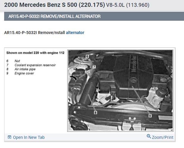

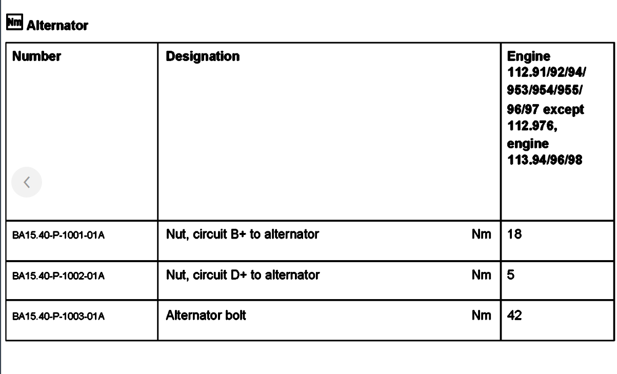

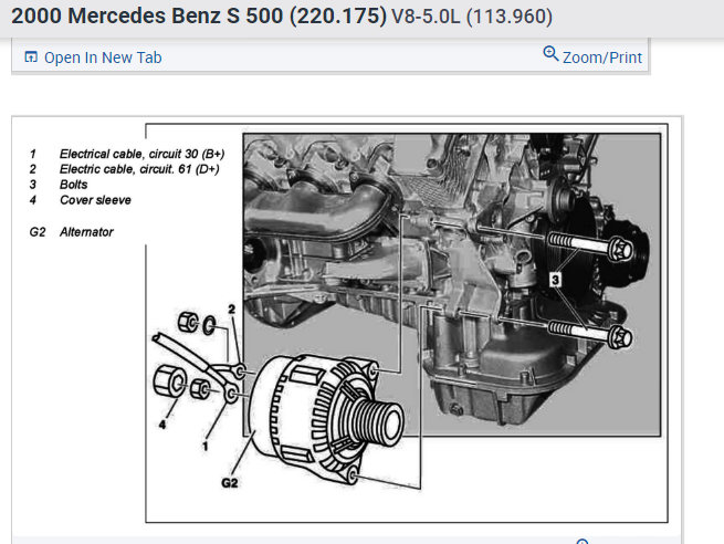

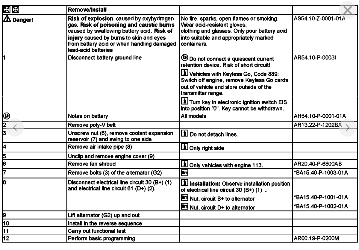

Have you tried to jump start the vehicle?
Does it crank over but not start? or just clicks? or No noise when you try to start it?
If you can jump start it but it does not stay running, then it could be a bad alternator.
When the alternator fails, it is unable to keep the battery charged and that leads to engine shutting off.
The alternator should produce 13.6V to 15.2V to the battery with the engine running.
If it just clicks when you try to jump start it then you could have an issue with the starter.
However, since it shut off on you it is either an engine sensor or bad alternator.
Please let me know what you are experiencing.
Thank you.
