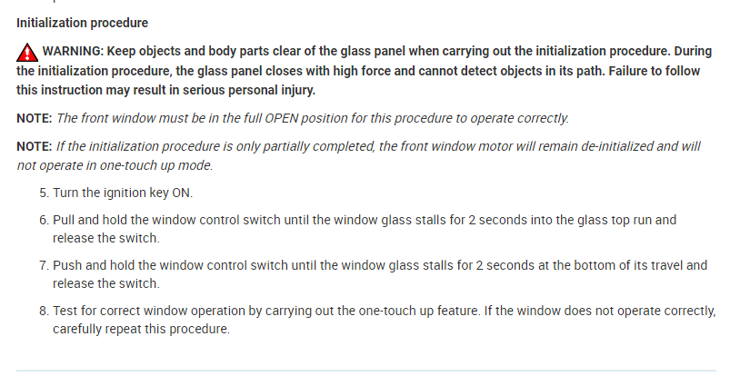

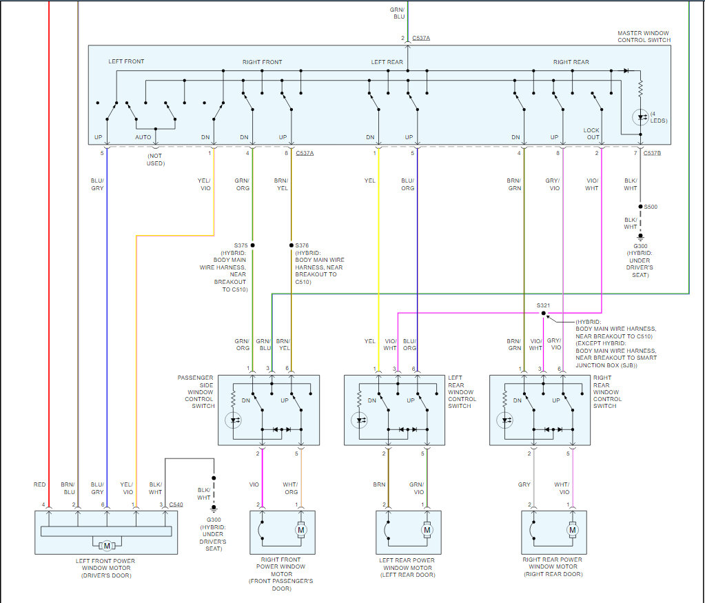

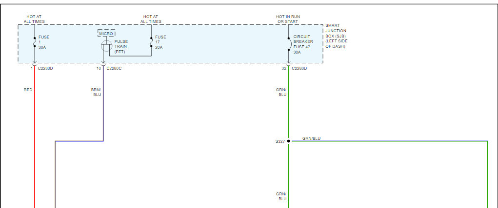

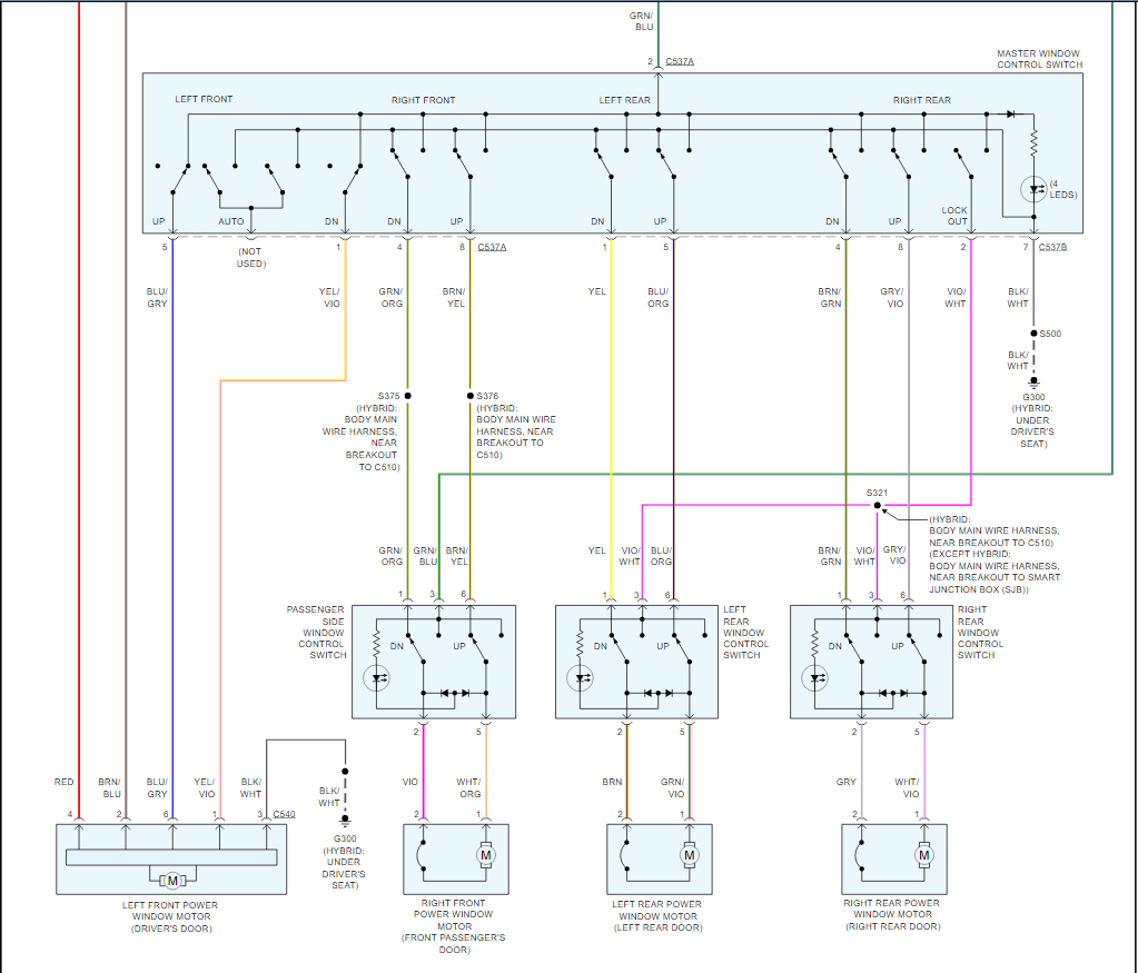

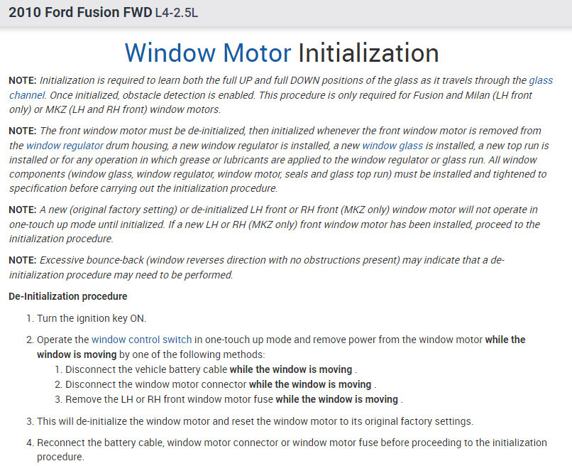

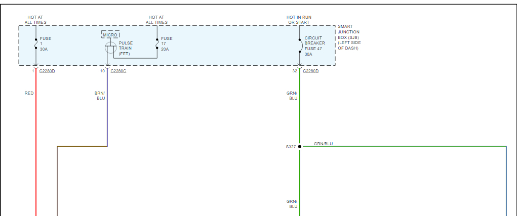

This could be due to a wiring issue. However it will probably be a good idea to do the relearn process and see it that takes care of it.
I have attached the window motor reset and wiring schematics for your reference.
