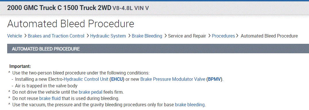

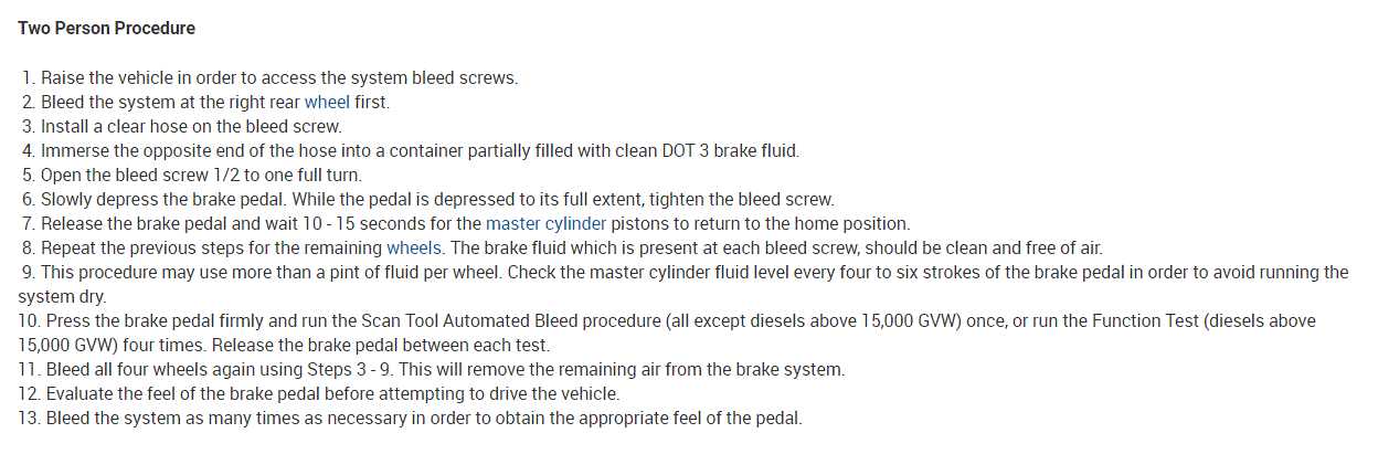

Did you perform an automated bleed on the ABS? Your description sounds like there is still air in it. That is where the issues usually occur.
I attached the directions below. Let me know if you have already done this.
See pics below. Note the automated bleed actually starts at number 10.
May 27, 2021 at 8:46 PM

I'm with Ken. I've done some research and poked around AllData. If the problem is mechanical, it would have to be either the master cylinder or the brake pressure modulator. Since you've replaced both, I'm thinking the problem must be a stubborn air bubble somewhere. You may have to jack one part of the truck way up as you go around the vehicle bleeding at each wheel, but that bubble will get worked out. Go through the guides that Ken has referenced and let us know what you get. I think that'll get you straight.
