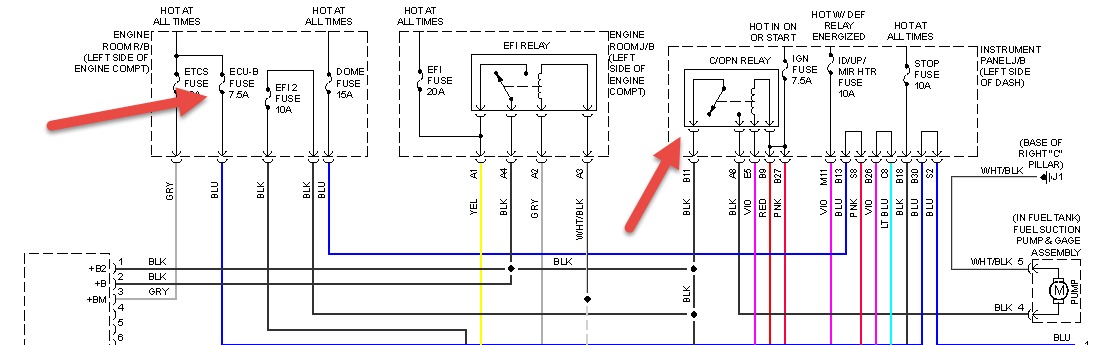

After replacing a stolen computer box and all coil packs,there is no current at the tank's high pressure pump black-trace-red lead,with all fuses fine.
After its computer box and all coil packs were stolen,and we bought other good and working second hand ones,a year 2007 toyota vitz has no current at the fuel tank's high pressure pump's black-tracer-red lead,and there isnt fuel pressure at the rail feeding into injectors. After feeding current direct from the battery to this black-tracer-red lead,there is a lot of fuel pressure at the rail feed pipe,and it starts up,though for few seconds,but fails to continue idling,and dies down.
We added to the tank 10litres of petrol. What could be the problem,and what needs to be done. I need to attend this car in two-three hours time. Please may you help as a matter of urgency. I thank you
