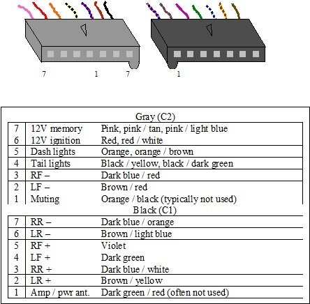

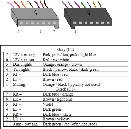

If you're getting no sound at all from your new radio, the most common cause is the amp hasn't been told to turn on. That is done on the "Switched 12-volt" line that could also feed a power antenna. Your new radio will have a similar wire that must be connected. Typically it's a blue or yellow wire, but it will likely be labeled. Terminal # 1 in the black connector is the one that must have 12 volts on it to turn the amp on. That's the dark green / red wire.

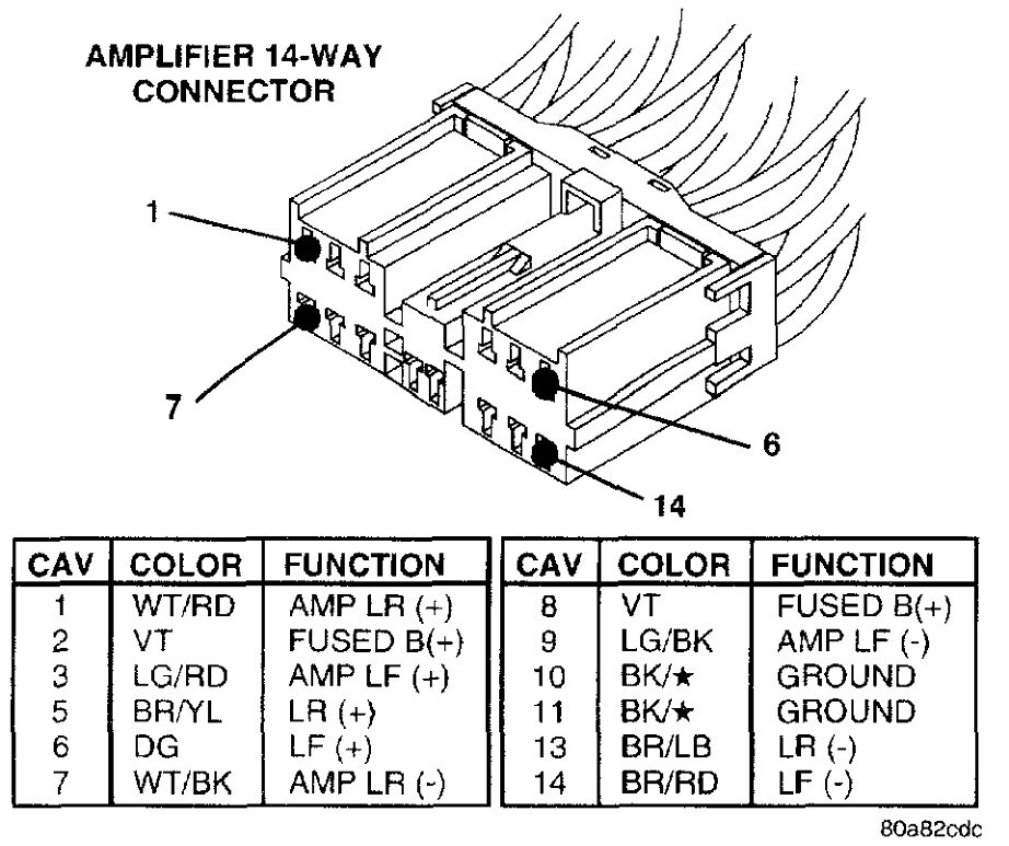

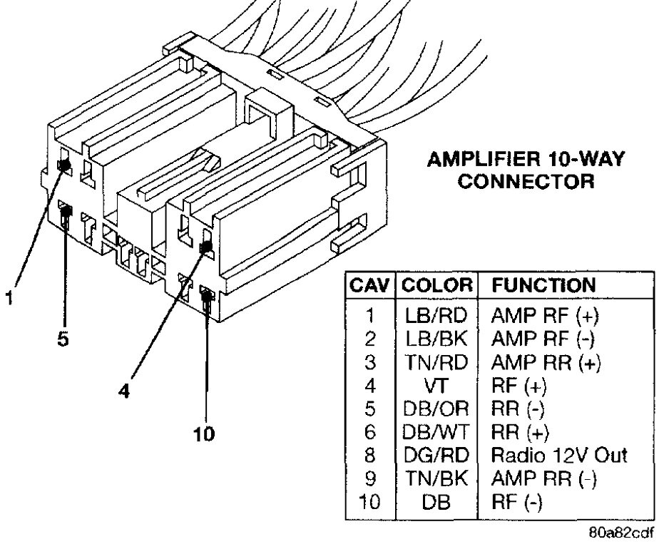

The easiest way to bypass the amplifier is to buy an adapter plug that connects to the amp's connector. Do a Google search and they should show up. The alternative is to cut the wires at the amp, then splice each input wire to its mating output wire. For example, the "Left Front + In" gets spliced to the "Left Front + Out". There will be eight pairs of wires to splice, two for each corner of the vehicle. By doing it either of these ways, you'll keep the left front door and the left front dash speakers connected and in the system. Same with the right front. I added the drawings for the amp's plugs. Let me know if you need help figuring out which wires to connect.
