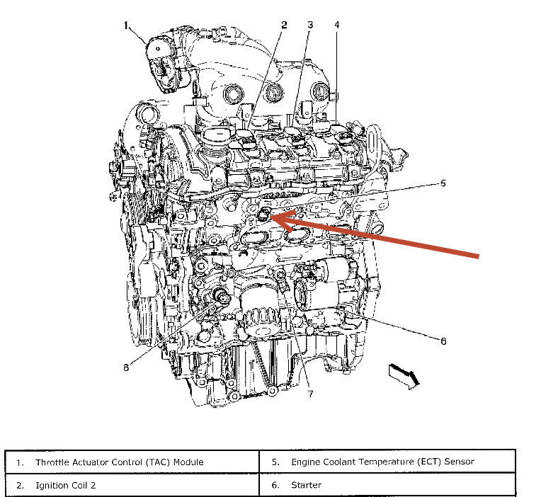

After changing spark plugs, HUD reads ENGINE HOT A/C OFF and the check engine light is on.. I got error code P0118 I'm hoping I cannot find where the engine coolant temperature sensor is... please help be it a diagram or advice...thanks!

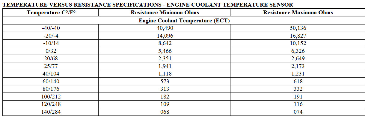

measure resistance of sensor first and make sure its' plugged in. sensor is item 5 in drawing see pics.
