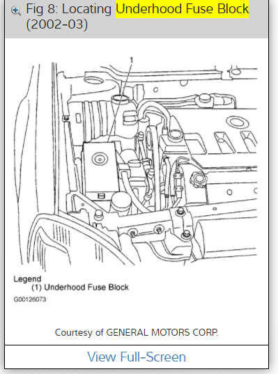

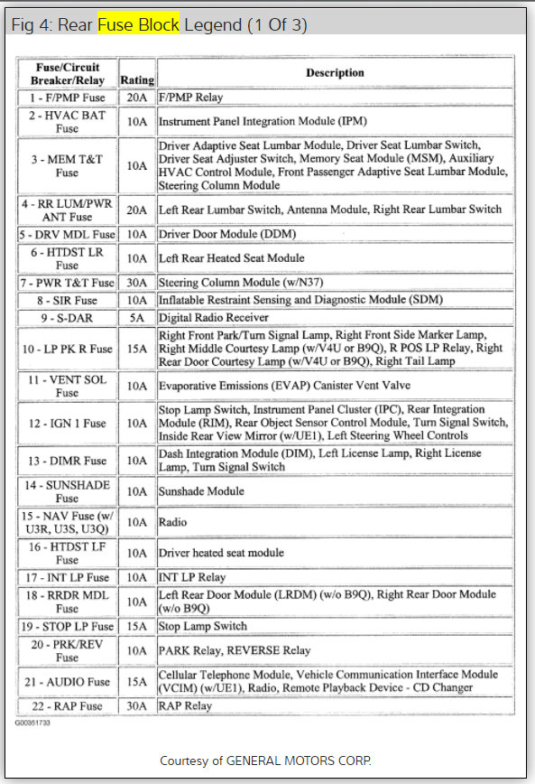

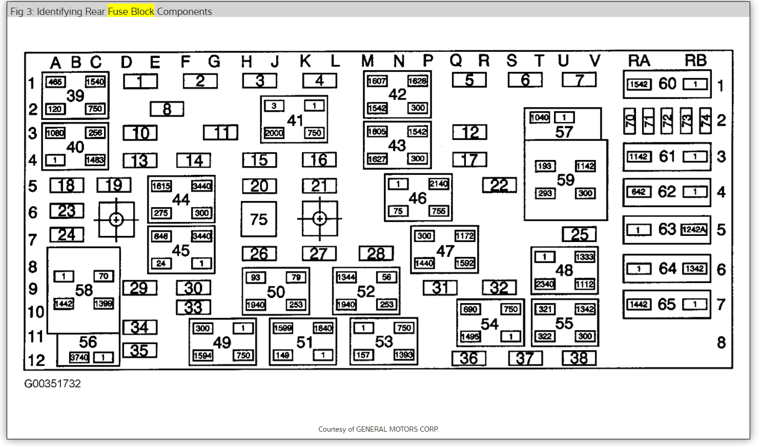

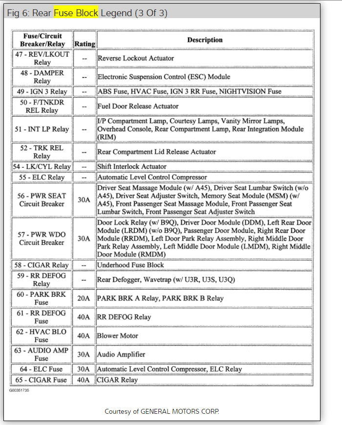

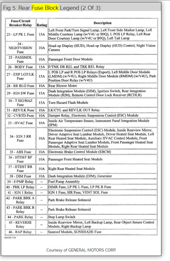

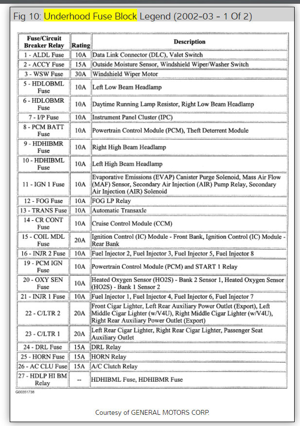

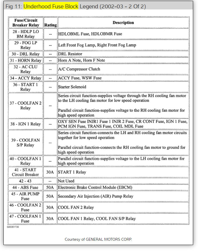

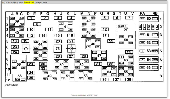

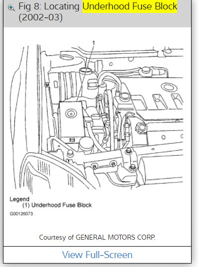

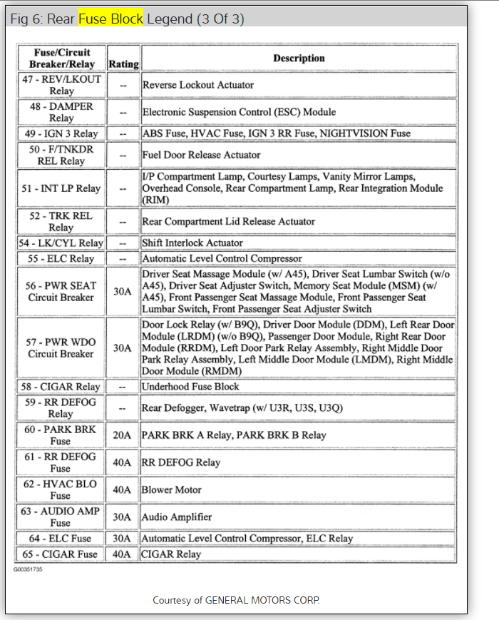

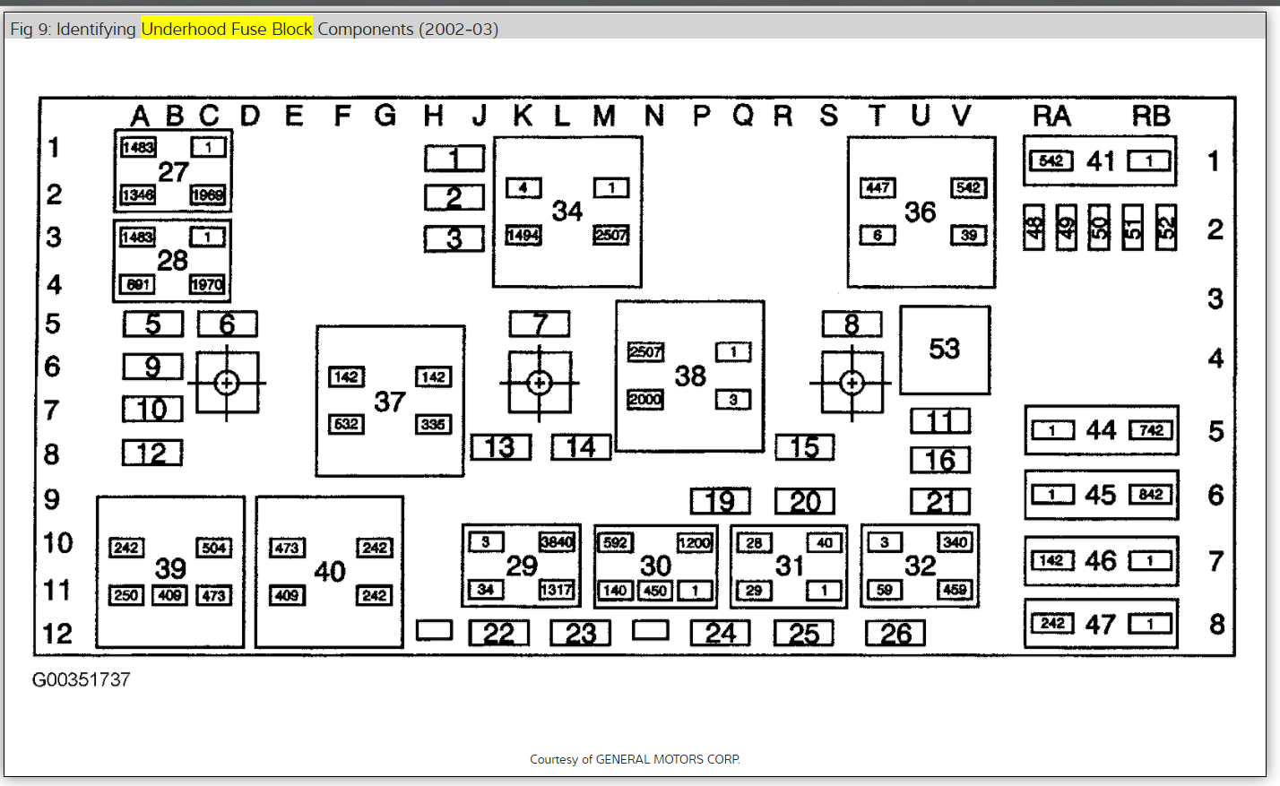

It sounds like the BCM has gone out but lets start by checking the fuses first. Here is a guide and the fuse locations to get us started:
