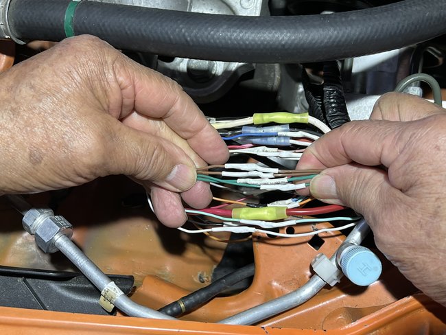

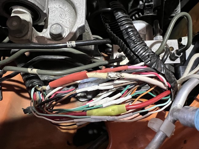

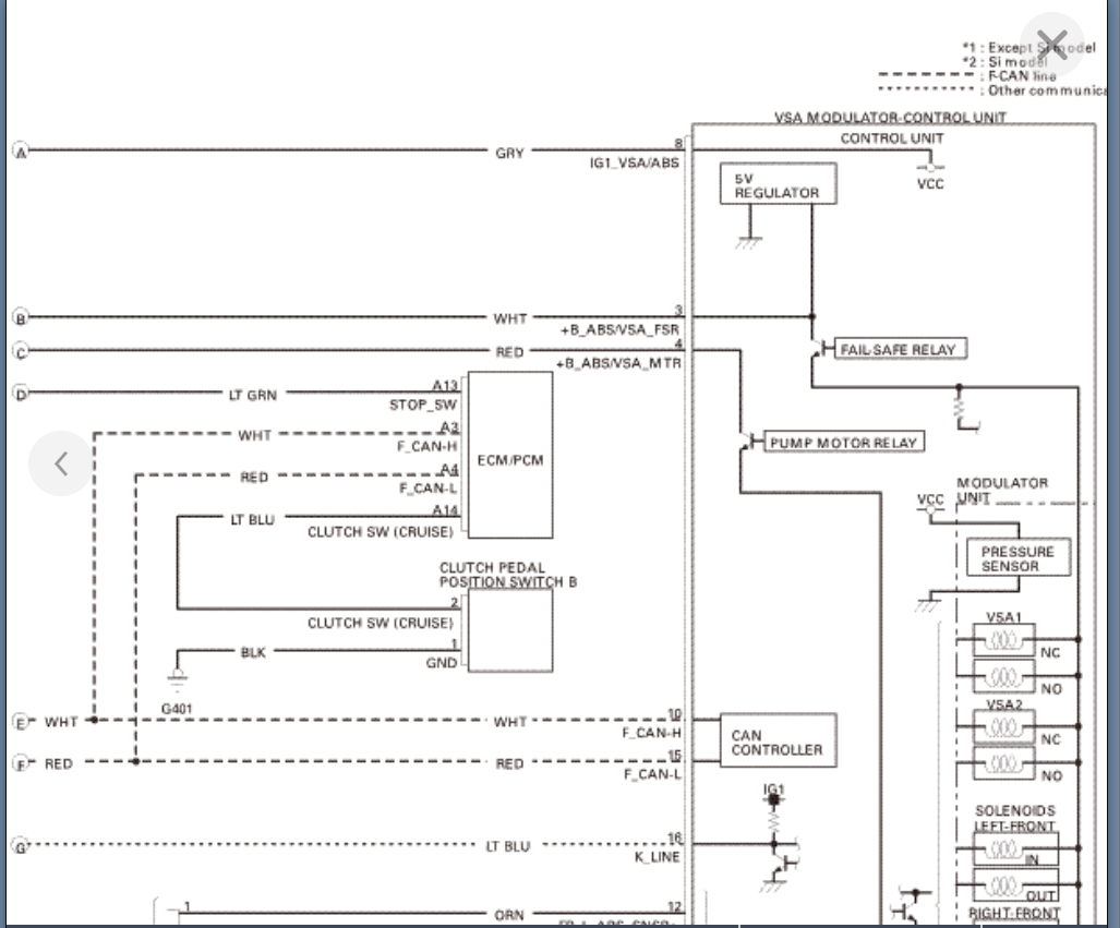

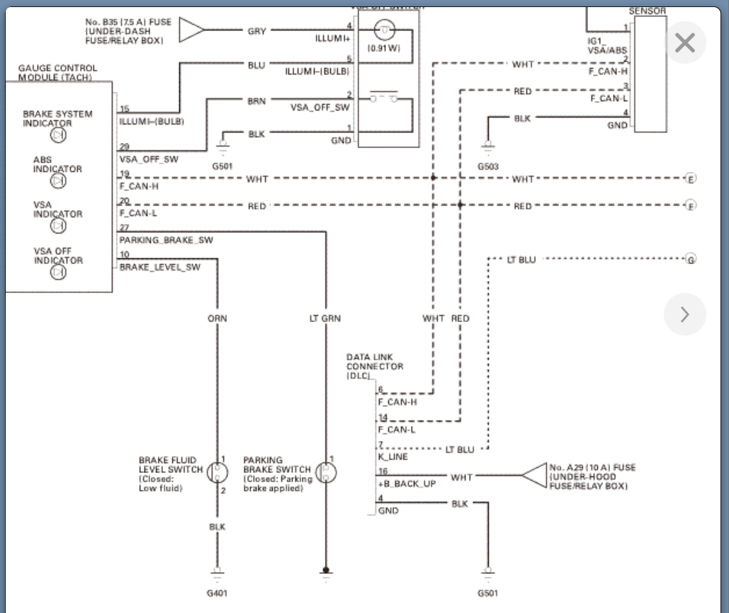

hello there, I'm back I start fixing the wiring as necessary here I want to share some pics there are no numbers on the wires, and I am not sure if there we have crossed wires due to the color are same two brown and two green? I'm not sure if you can help me with the electric diagram, I'm good at reading those diagrams.
Victor
Feb 21, 2022 at 4:40 PM
That is the ABS connector? If so, then the only way to know is to trace the wire to find out where it goes into the ABS and then that will tell us what terminal it is in. Then we can go to that component and disconnect it and check continuity from that pin to the other end and that will tell us if it is wired correctly.
The brown wires may be ground so if that is the case then it doesn't matter if they are backwards. However, the green could be a wheel speed or the stop switch.
Did we ever check for codes? If you have some circuit codes, then that will tell us where to start.
