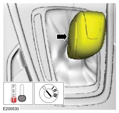

1. Position the selector lever in D (Drive). Turn the ignition off.
pic 1

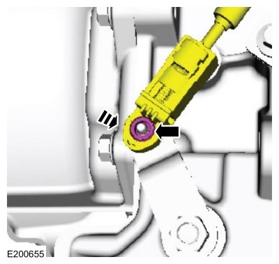

3. Disconnect the selector lever cable from the manual lever.
pic 2

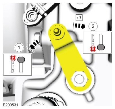

4. Position the manual lever in D (Drive).
1. Rotate the manual lever counterclockwise until it stops.
2. Rotate the manual lever 3 detents into D (Drive).

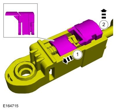

5. Unlock the adjuster.
1. Slide the spring-loaded tab forward.
2. Lift up the adjuster lock.

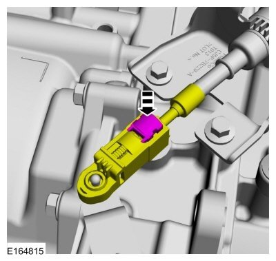

6. Connect the selector lever cable to the manual lever.
pic 5
