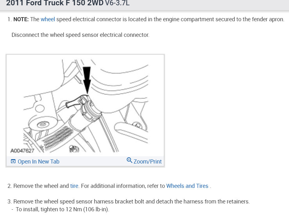

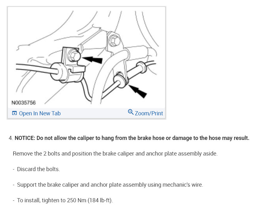

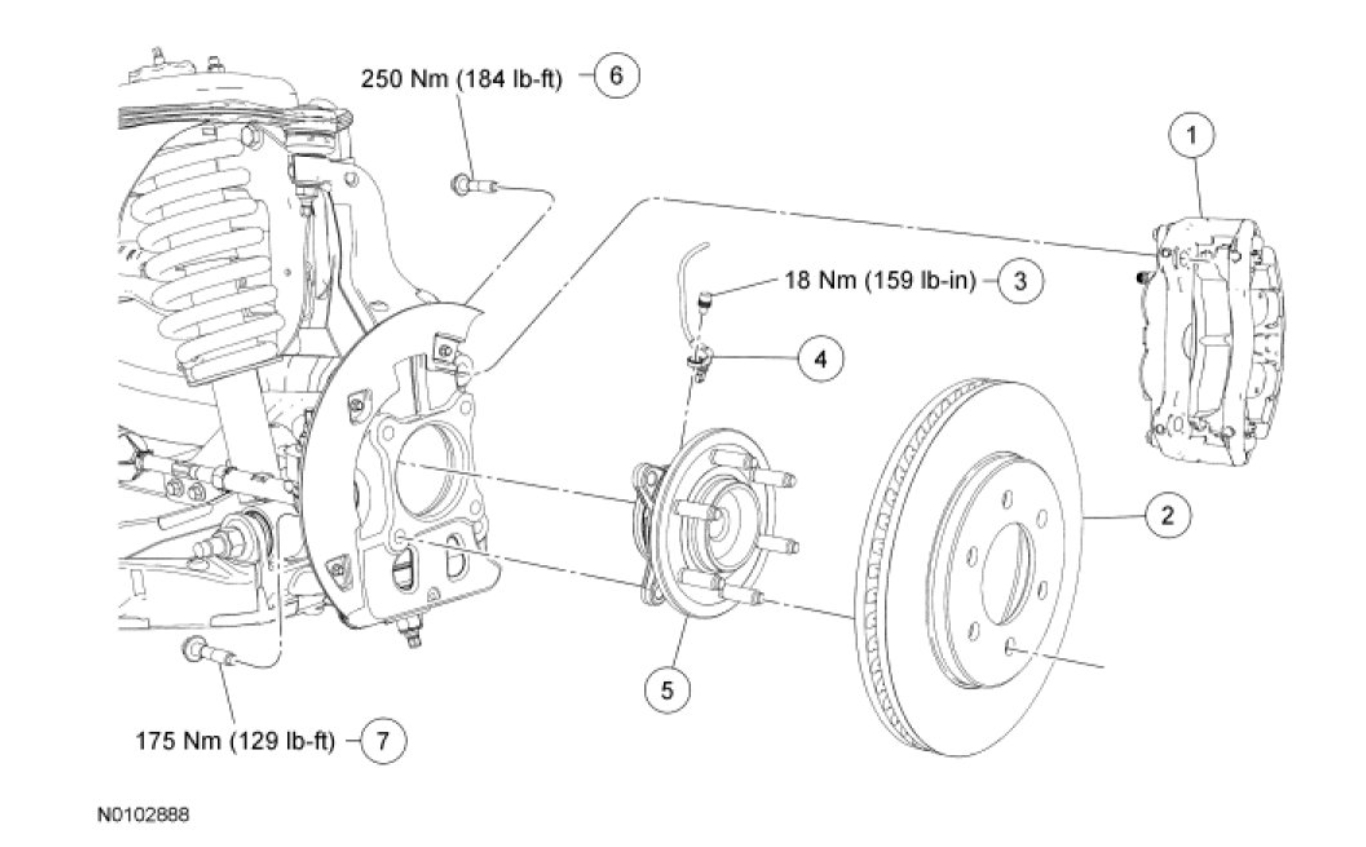

It sounds like you have an ABS wheel speed sensor going out which will cause the issue you are having. Here is a video to help you run the codes so you can see which sensor it is. Probably the front wheel bearing hub.
https://youtu.be/rTtAnsOlZU4
This video shows the job being done on a similar truck.
https://youtu.be/ZgiPRG6jffc
