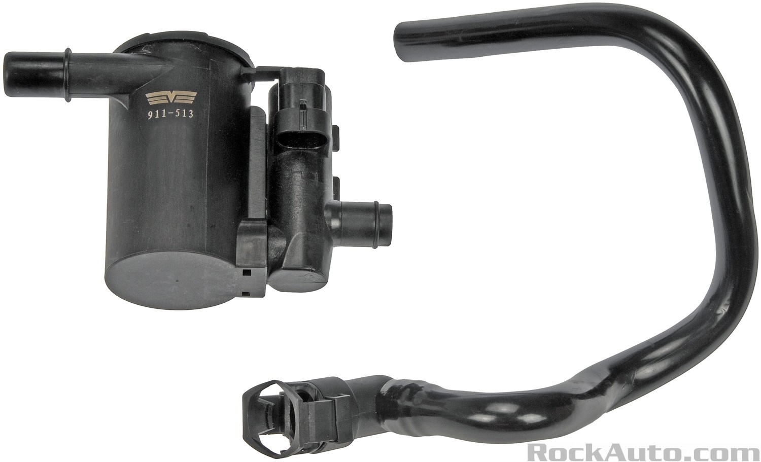

The canister vent solid is below center of vehicle near fuel tank. you do not want to waste money on bad guesses as well though.The vent solenoid should be normally open.
Jan 2, 2017 at 7:00 AM
SATURNTECH9
  • 30,869 POSTS
I posted what the vent valve looks like .
Jan 2, 2017 at 7:06 AM

It should be there it is just a connector a couple of hoses and a bracket.
