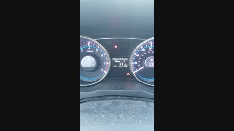

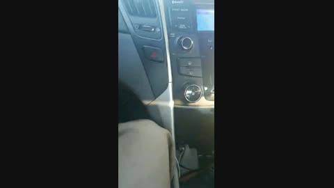

Well my car has got to the point where it isn't shifting right at all. The knocking continued. I even took it to an NTB and the lady refused to service my vehicle due to "liability" last night. I was furious and now I'm not sure what to do. Today I have to call around to see if other place are going to say the same thing.
The videos are different times the one of the dash shows my miles to empty changing. The second let's you hear the knocking while I'm driving. Upon accelerating it is sluggish and the knocking got louder. Again, now since last night anyway, the car is super hesitant and is pretty much not safe to drive on highways.
Oil doesn't seem like it did anything good for me by adding it for all this to have happened.

Yeahhhh that's definitely not a good sound. And I'm not too surprised about NTB not wanting to touch it. They generally don't want to touch cars that are making knocking noises because they don't want to be blamed for an engine kicking the proverbial bucket shortly after leaving their store. Hence the "liability" avoidance.
