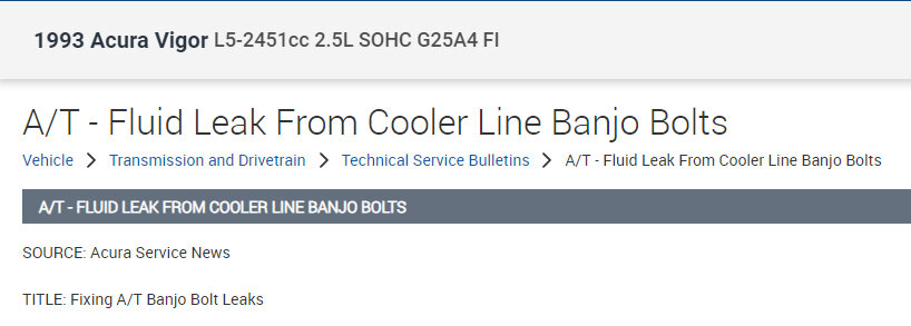

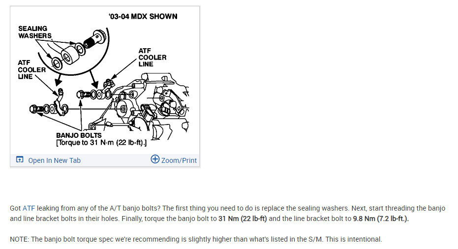

There is a chance the leak is from a transmission cooling line. Years ago, there was a technical service bulletin out related to the "banjo bolts" leaking where they attached to the transmission.
If you look below, I attached the technical service bulletin for you. It explains how to fix the issue. Note, this is a theory at this point. If you follow the transmission cooler lines from the radiator to the transmission, it will lead you to this point. Check to see if that area is all wet.
See pics below.
