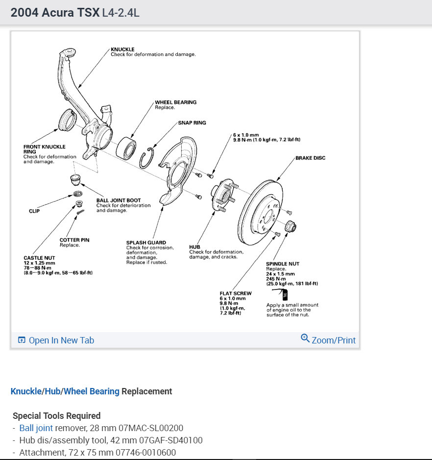

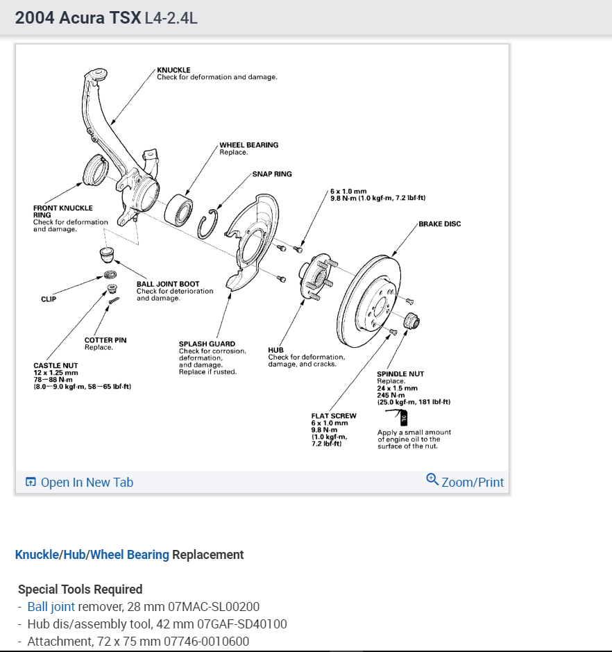

Hi Mohammad,
It sounds like you have a bearing hub that is out causing the Wheel speed sensor no to read right here is a video to help get the codes so you can confirm which side it ie, I would do both though fyi.
https://youtu.be/rTtAnsOlZU4
This guide will walk you through the repair with diagrams below to show you how on your car.
https://youtu.be/_FzmmBoa4Tg
Check out the diagrams (Below). Please let us know what happens.
