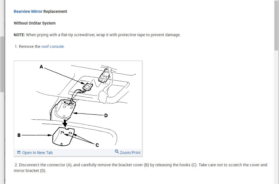

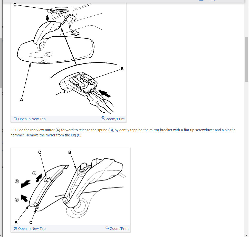

How do I remove the interior mirror, checked with the local honda dealer but they didn't know. Closest Acura dealer 400 miles away.
Thanks,
John
Nov 2, 2007 at 7:20 PM

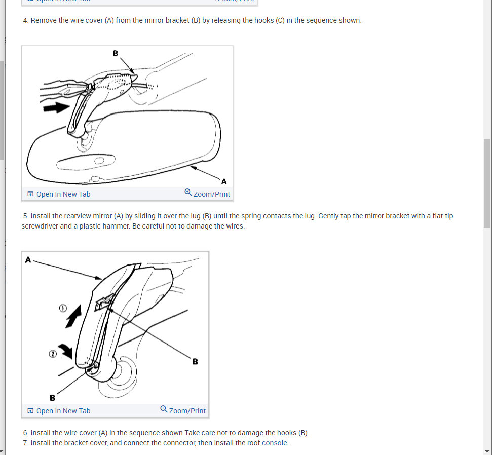

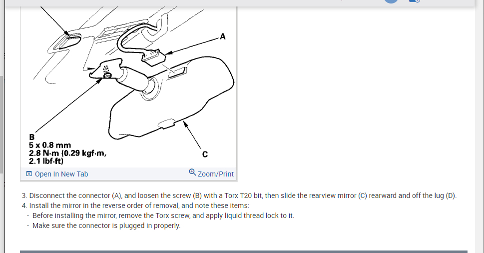

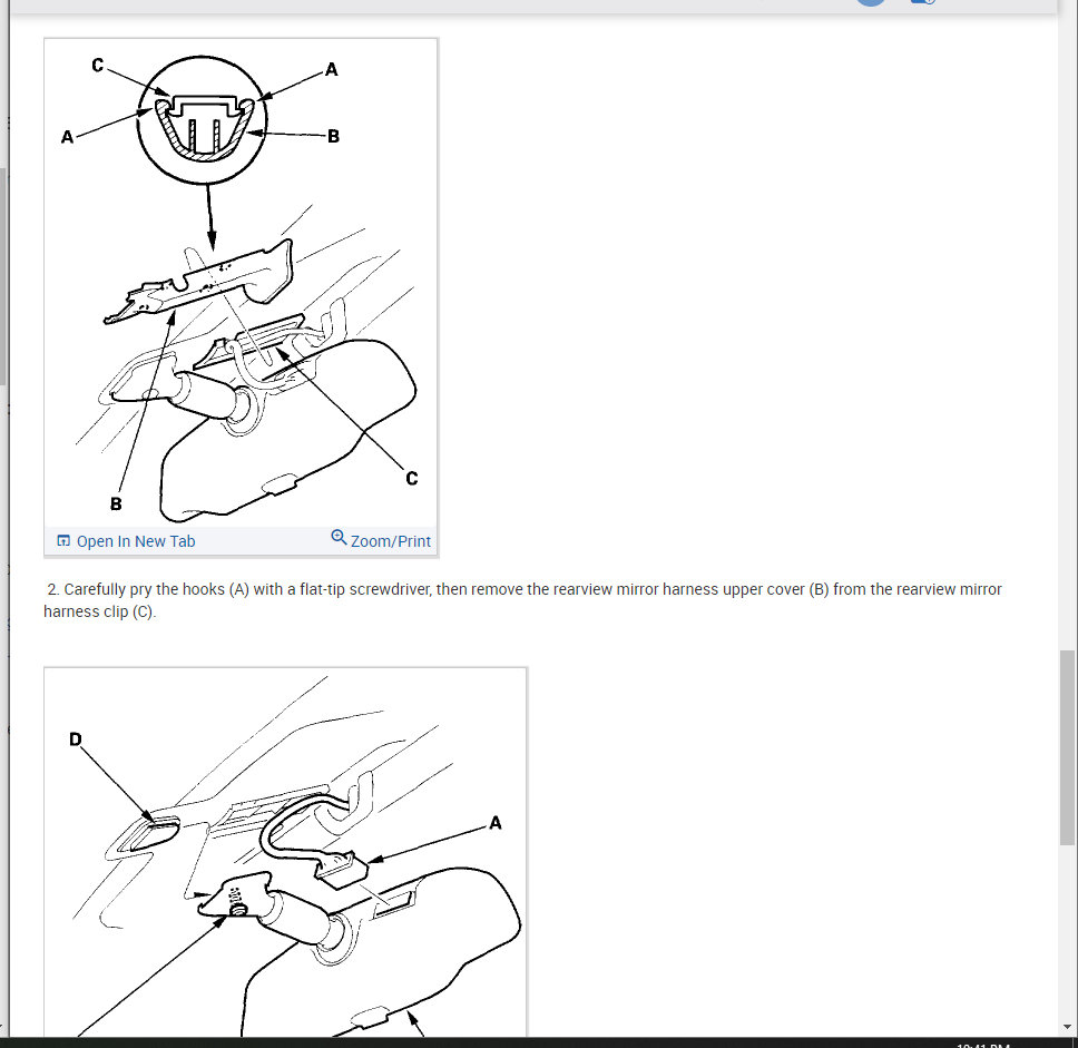

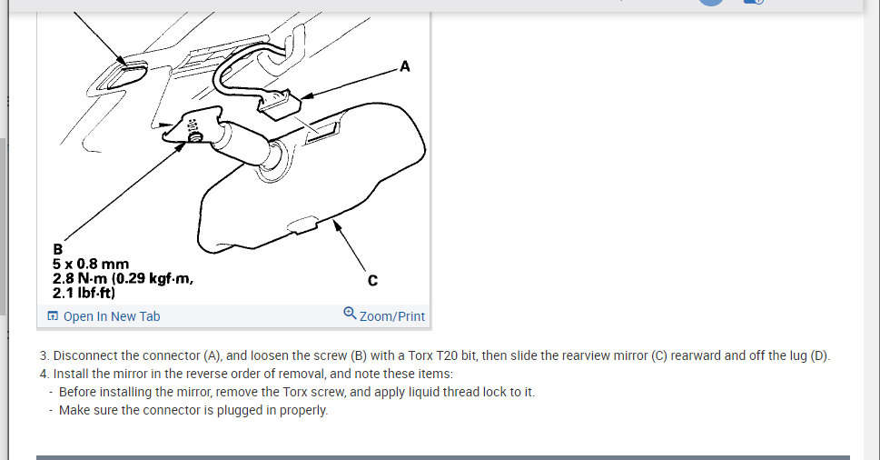

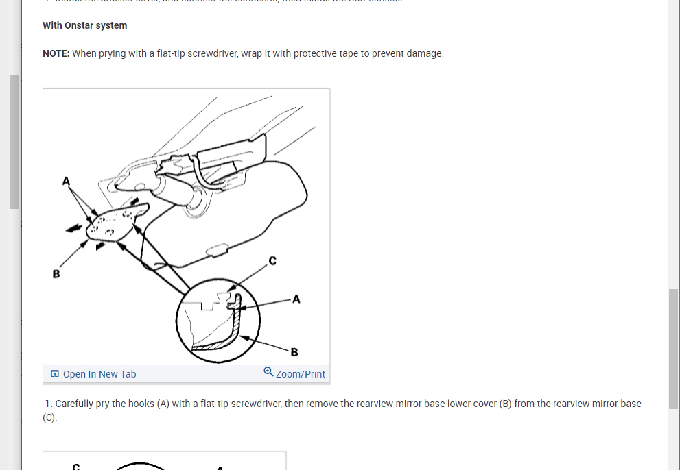

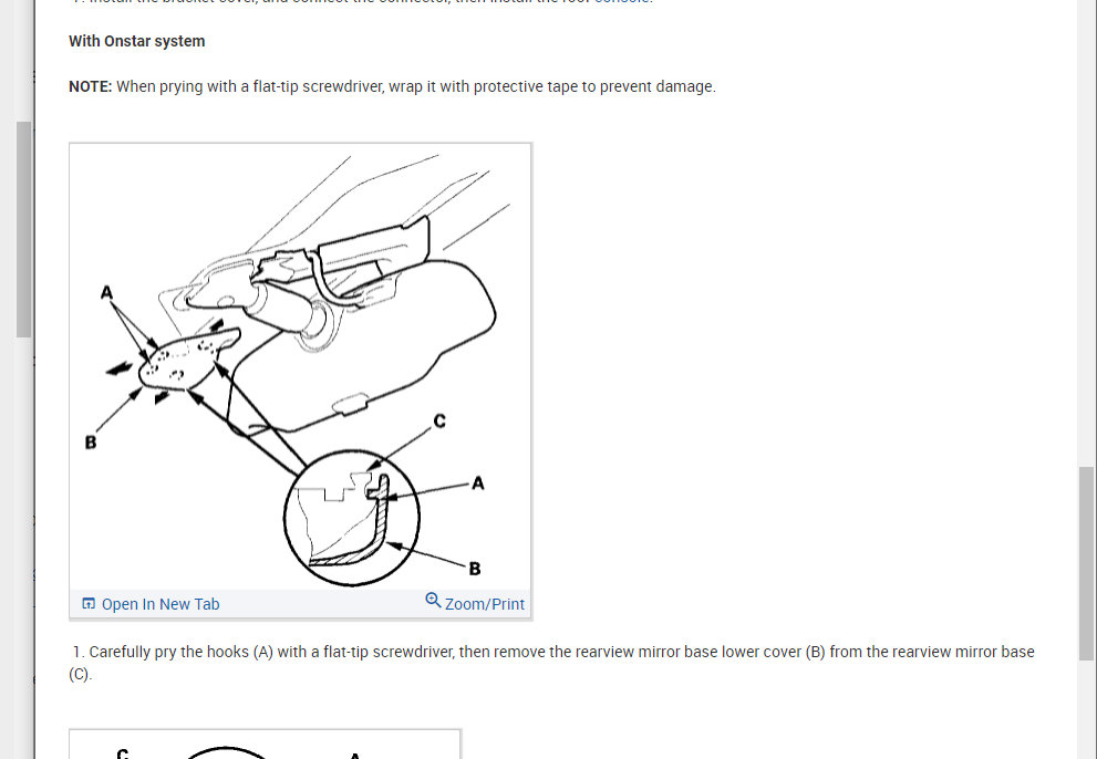

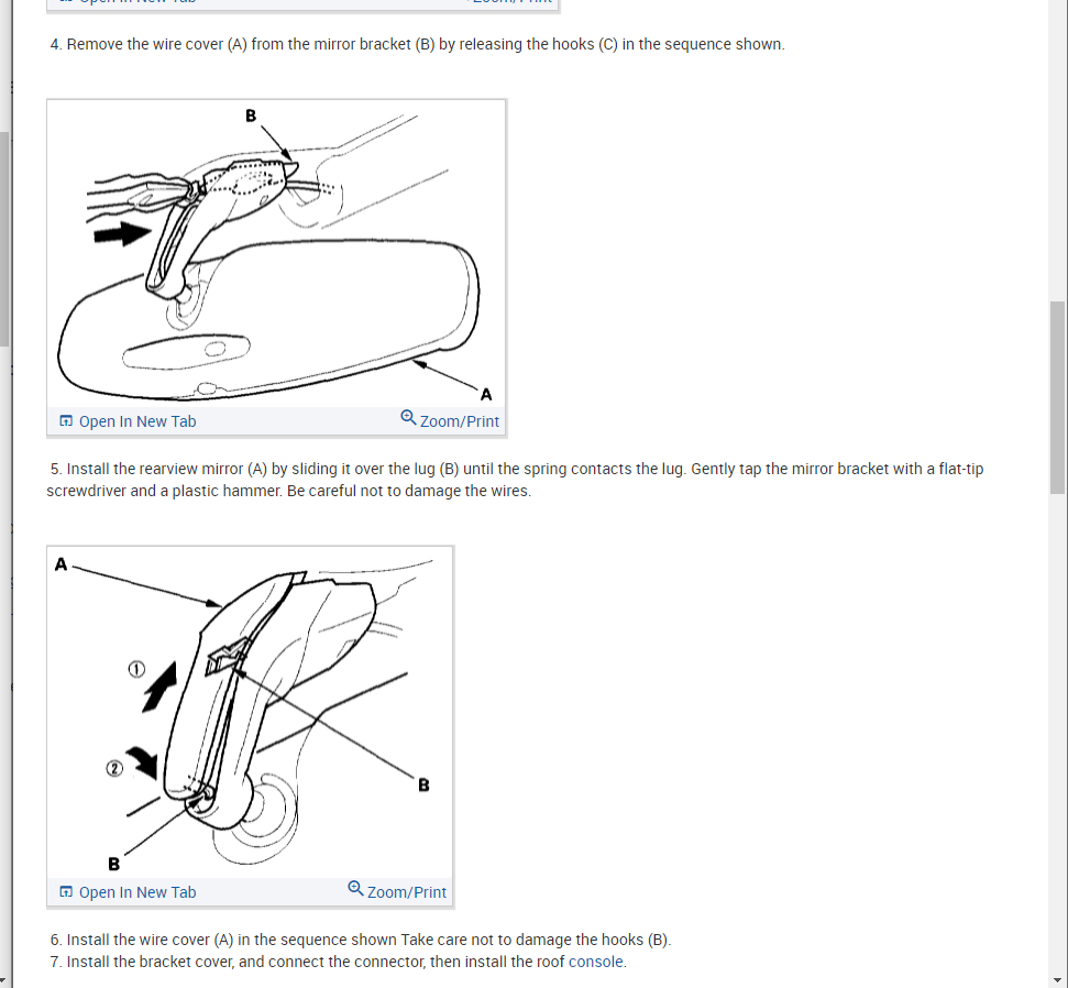

I am attaching the process from the manual that will provide the detail that you need in order to replace this mirror.
Please see below for this info and let us know if you have other questions. Thanks
