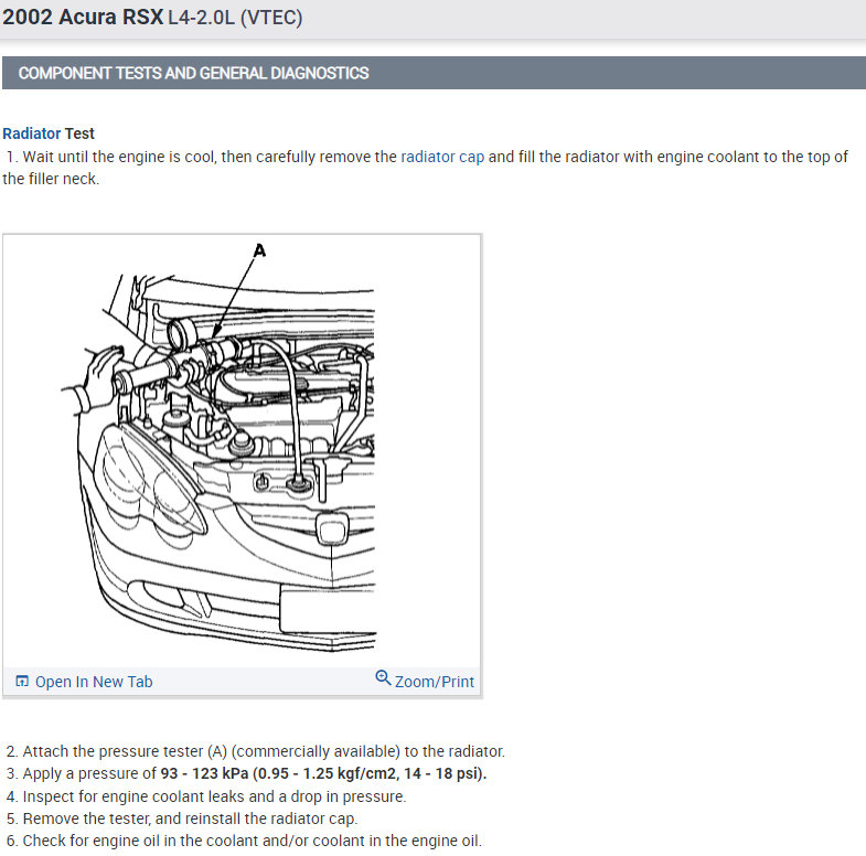

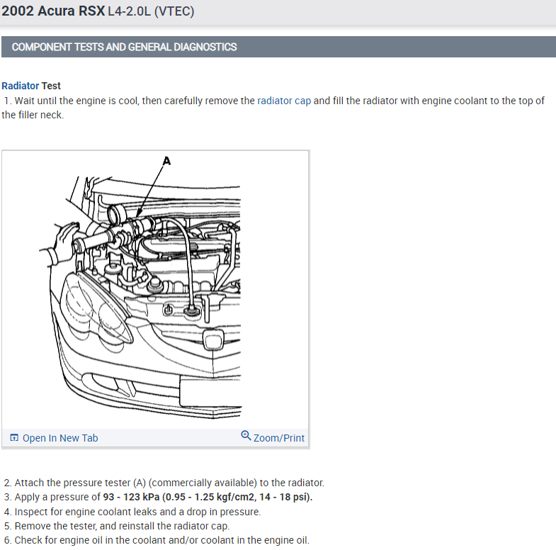

You can also pressure test the radiator for any leaks. There is a easy to use tool that adds pressure to the radiator system to see if there is any leak. This tool can be borrowed from just about any parts store.

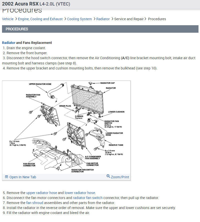

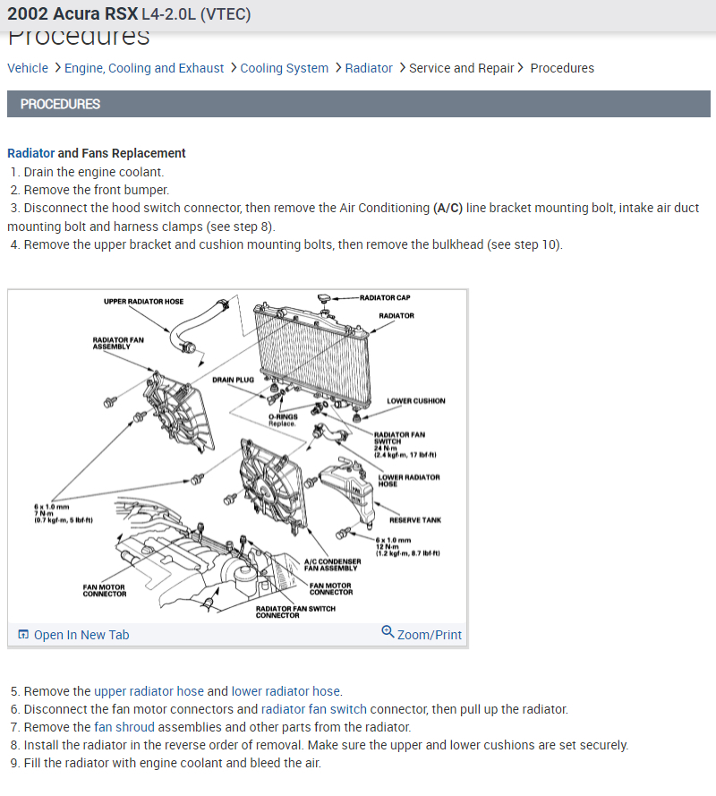

Here is a helpful guide of how to change the radiator:
https://www.2carpros.com/articles/how-to-replace-a-car-radiator

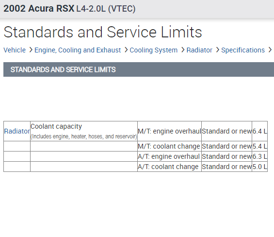

I have also attached the radiator replacement procedure as well as capacity of coolant for your RSX.
