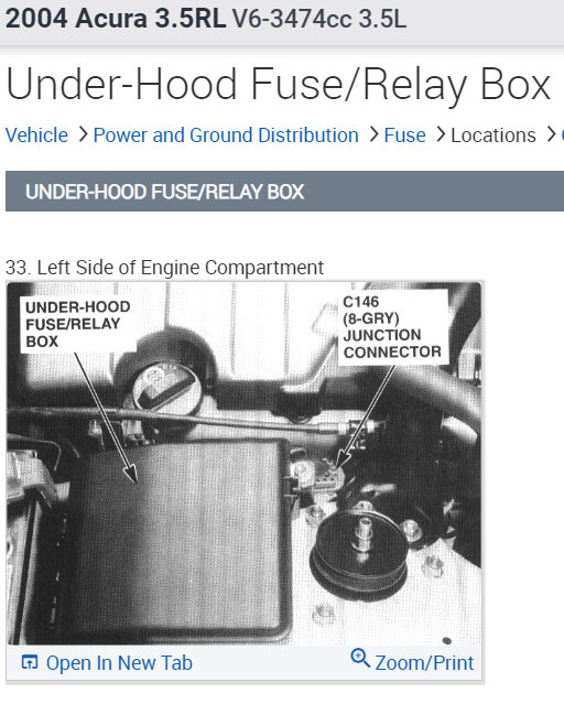

Okay, it sounds like the cigarette relay is not working (shorted). Here is the location so you can swap it out under the hood fuse panel. Check out the images below. Please let us know what happens.
