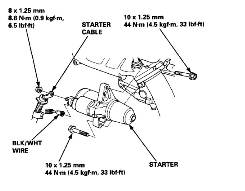

Six cylinder front wheel drive automatic 148,000 miles.
Where is the starter located and what is the process to replace it? Some have commented it can be done others have said do not attempt it. let a mechanic do it.
