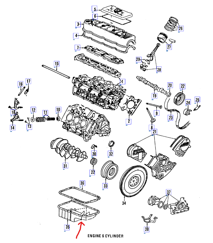

The two V6 engines used on Legend models have hydraulic valve lifters which do not normally require adjustment. It sounds like you may have a clogged oil pump pick up which is common when the engine oil changes have not been done regularly. Here is how to remove the oil pan so you can clean it out along with the oil pump pick up. Check out the images (below). Let us know what you find.
