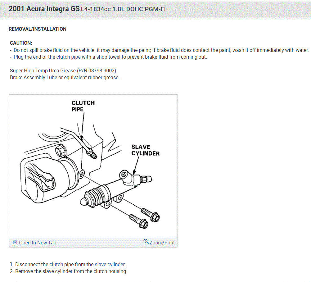

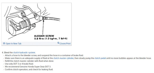

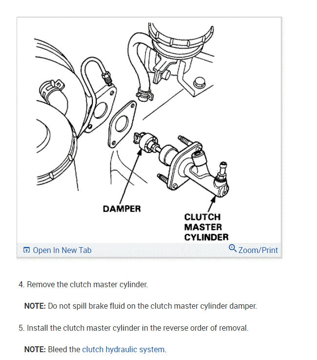

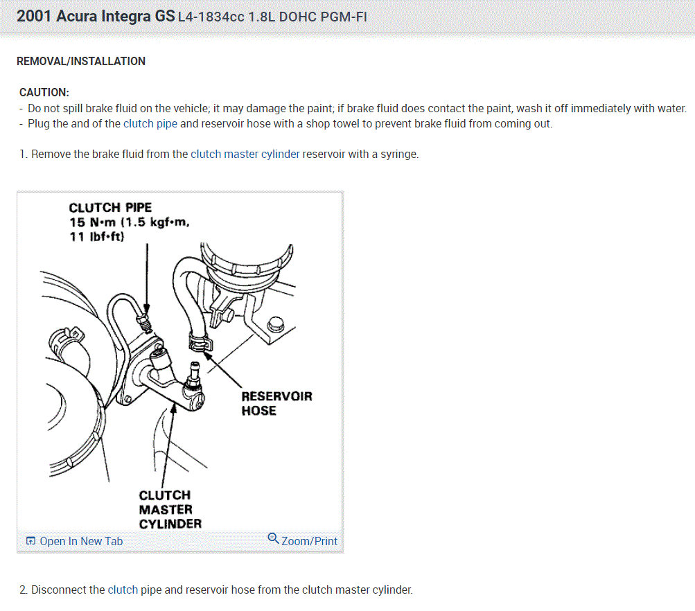

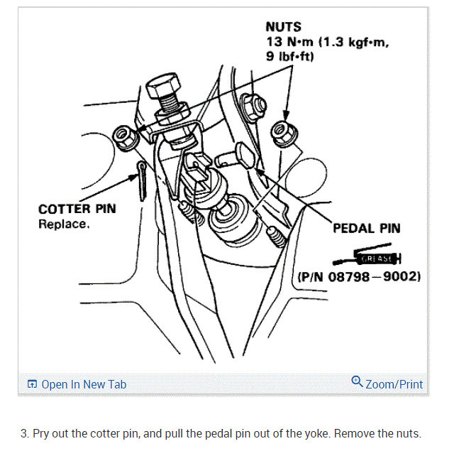

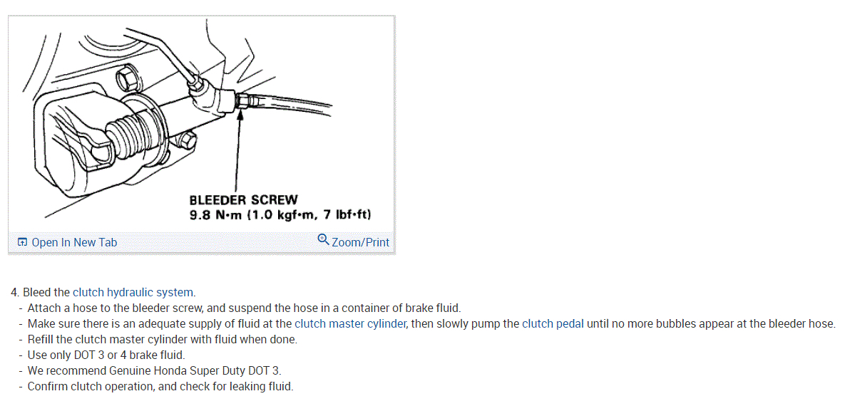

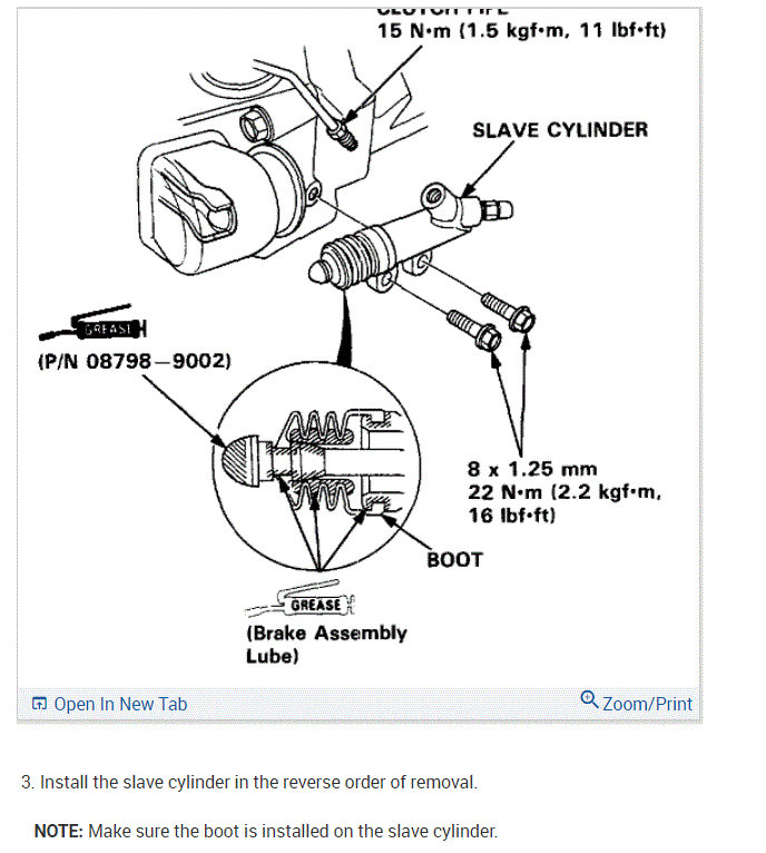

If you do determine one or the other is in need of replacement, I attached the directions specific to your vehicle below. The first set of directions is for the clutch master cylinder CMC. The second is the slave cylinder.
The last step is to bleed the system. The directions are on the last pic below.
