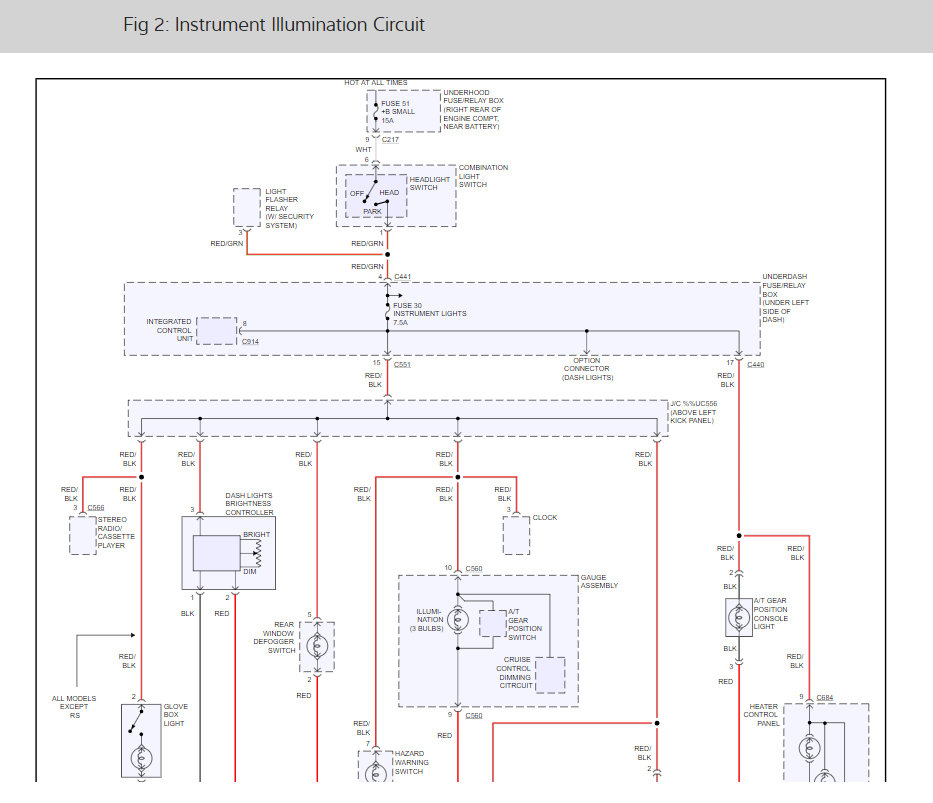

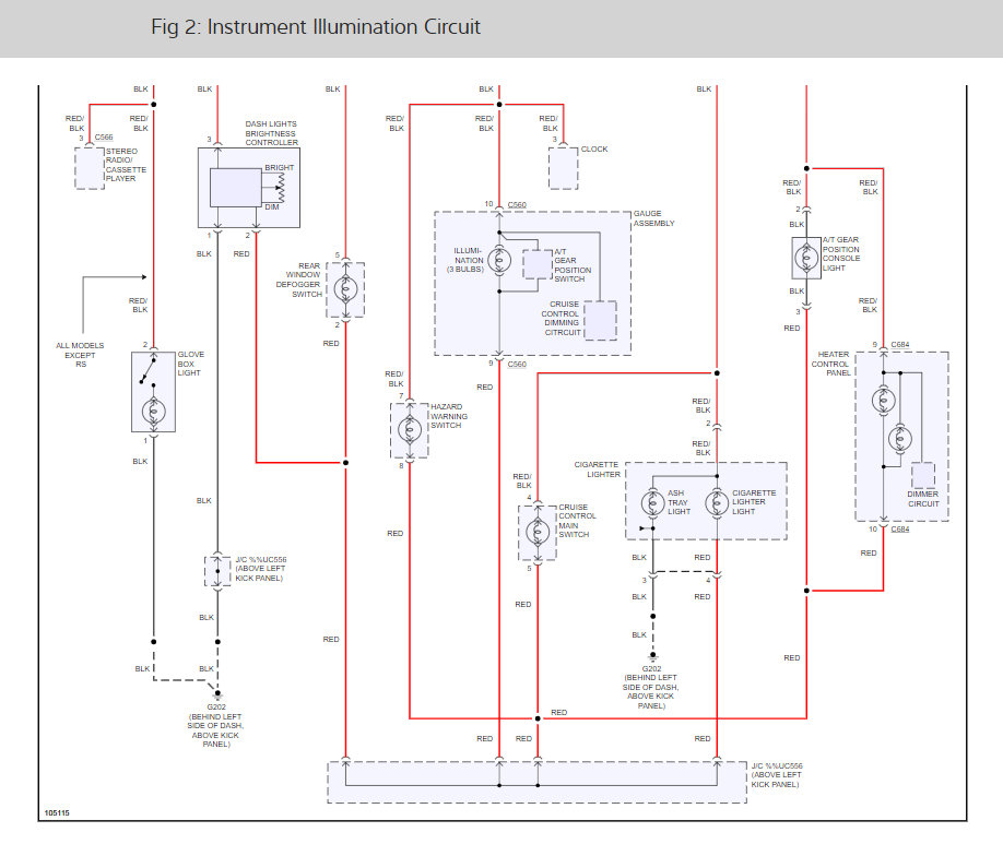

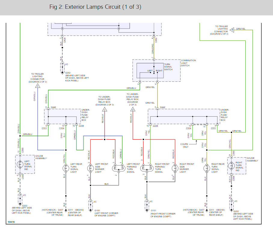

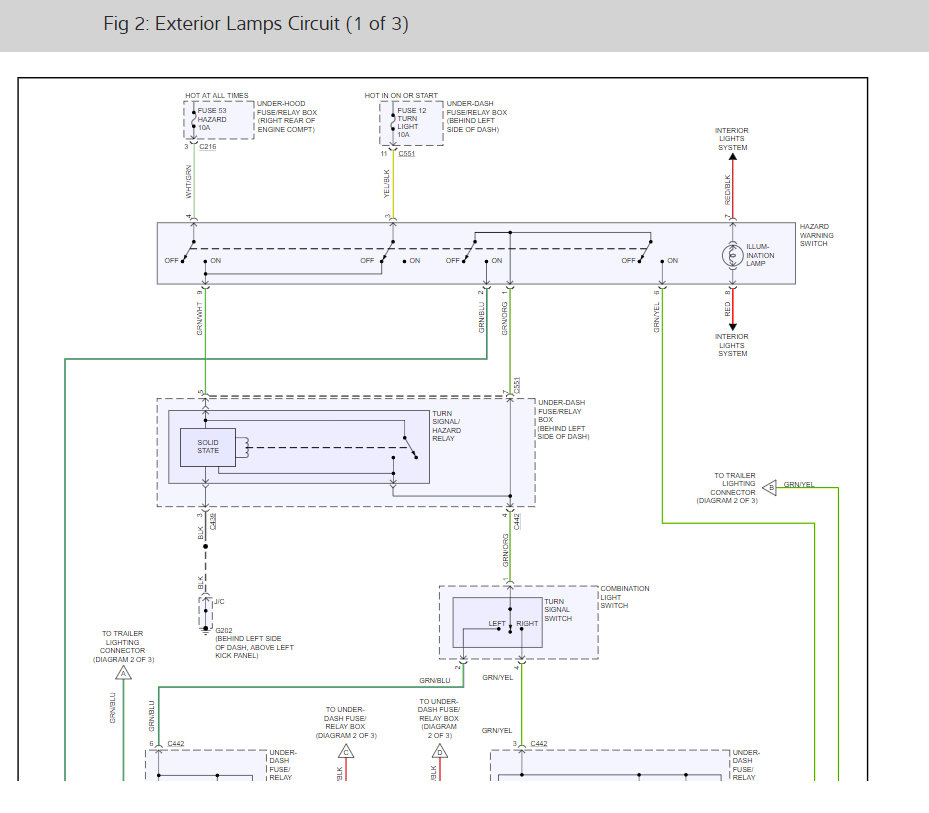

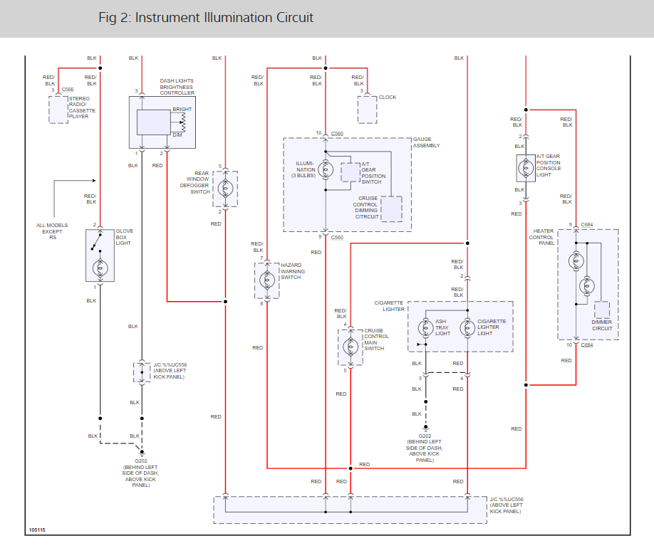

When I turn the lights on to the parking light position, everything works fine. When I change the position to full lights, my instrument lights in the dash and my tail lights do not work. I can nudge the position back to slightly in between the two positions and get weak, but workable, tail and instrument lights. What do you believe might be the problem?
Jan 16, 2008 at 4:31 PM
JEREMIAH
  • 217 POSTS
Without looking at the car,my best guess would be that it's a bad headlight switch. Here is a guide t help test the switch with the tail light wiring diagrams so you can see how the system works, also there is a tail light relay that needs to be checked.
and
Check out the diagrams (Below). Please let us know what you find. We are interested to see what it is.
