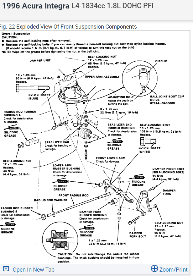

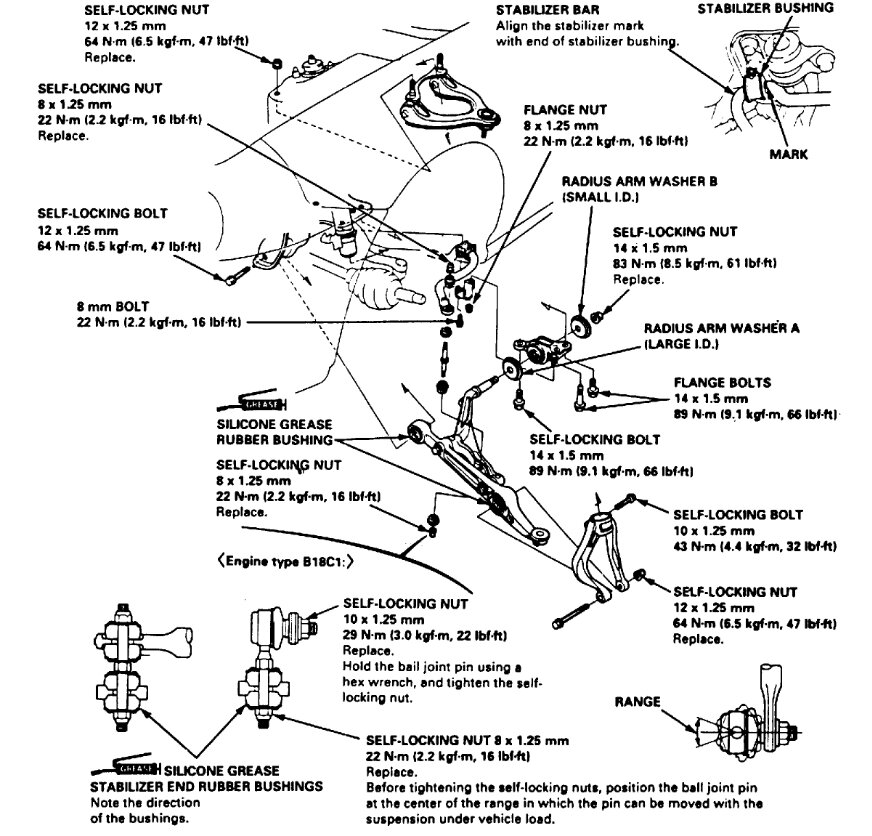

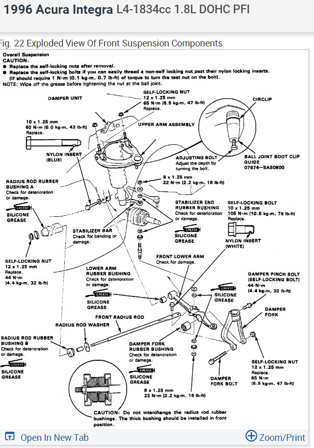

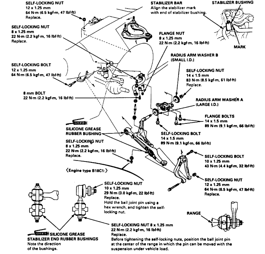

Yes I would change them both out, here is how the job is done which will cost about $450.00 to have it done. Here is how to do the job yourself if you want to save some money.
Here is a generic guide to help you step by step with instructions in the diagrams below to show you how on your car.
https://www.2carpros.com/articles/replace-ball-joint
