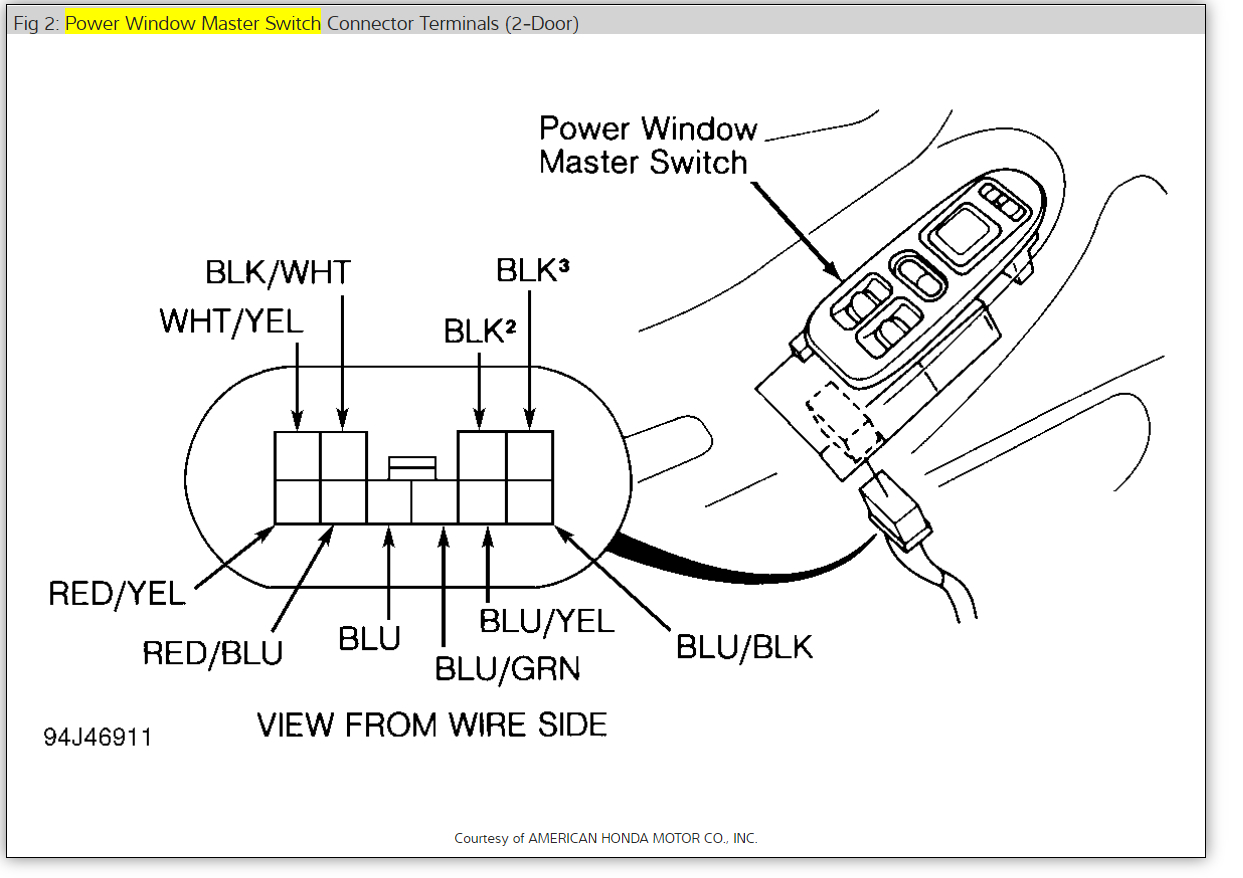

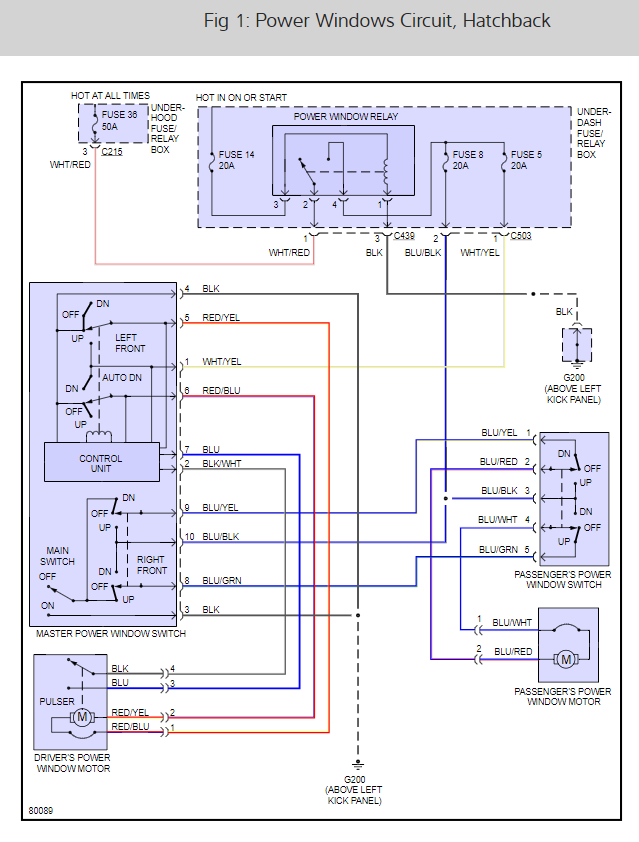

Hi n9jc,
Check the driver door master switch. If it is faulty, it would not allow the other windows to work. It could be a bad ground or broken wire for power supply between the driver door and the other doors.
As to the door locks, does the driver door key and lock work correctly?
You mentioned the passenger door lock does not work the central locking but the key switch does. The key switch is good but the door lock switch is not. You would have to test the door lock switch.
Here is the wiring diagram and a guide on how to check the switch.
