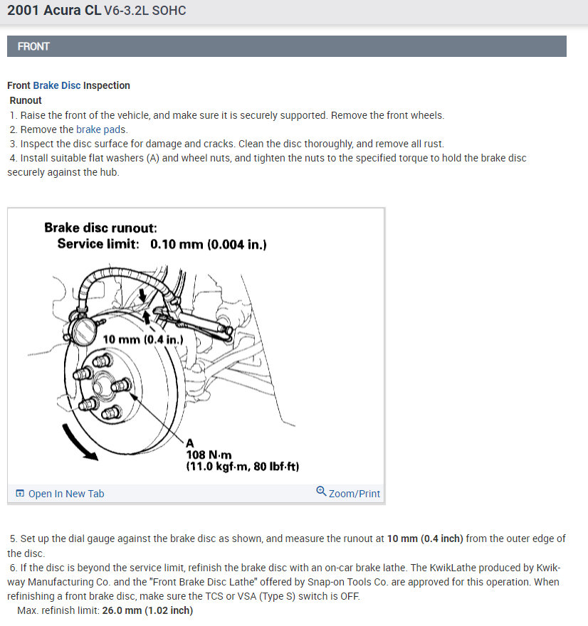

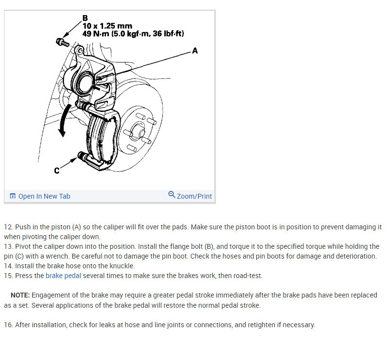

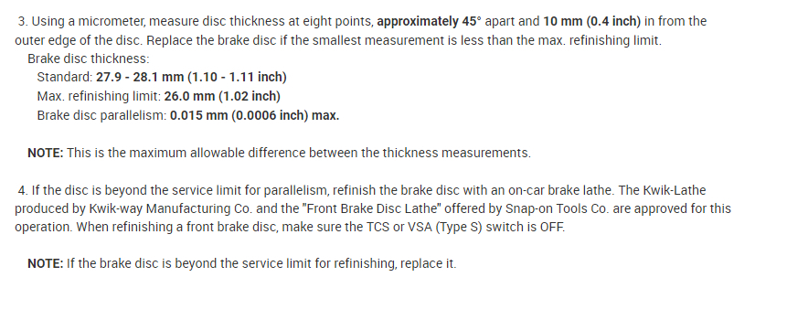

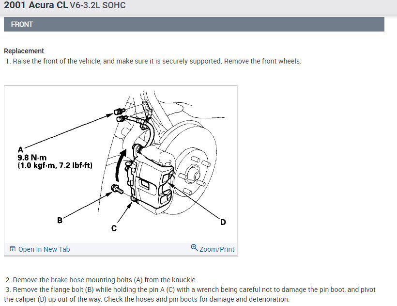

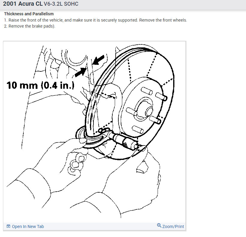

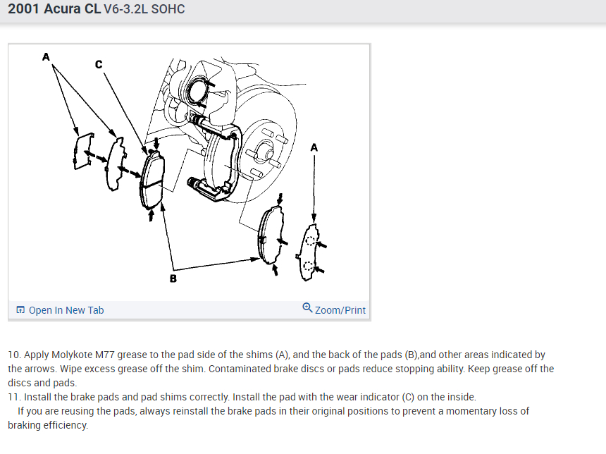

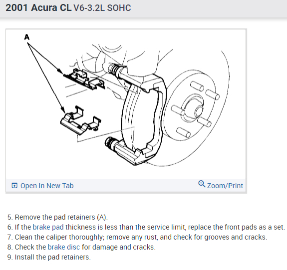

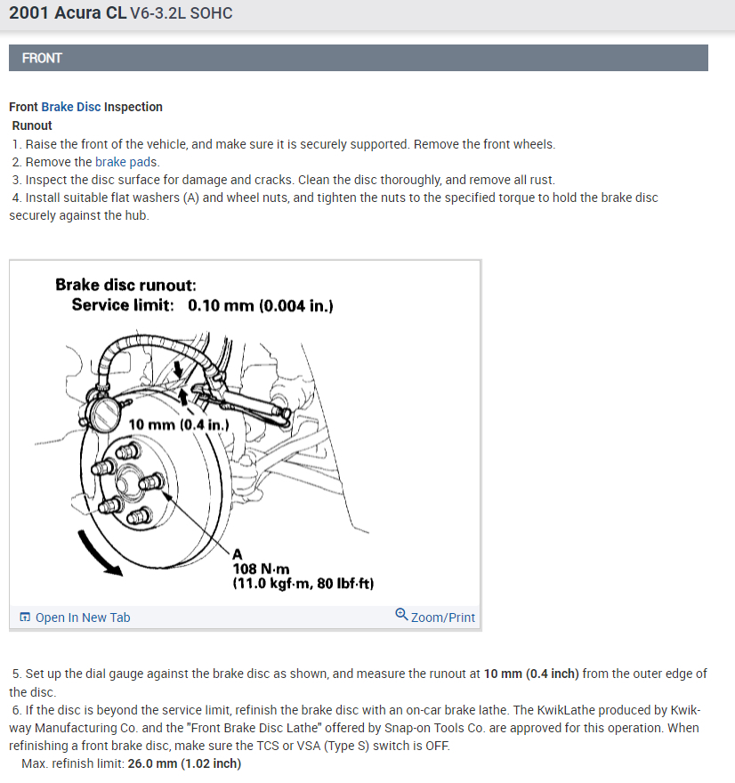

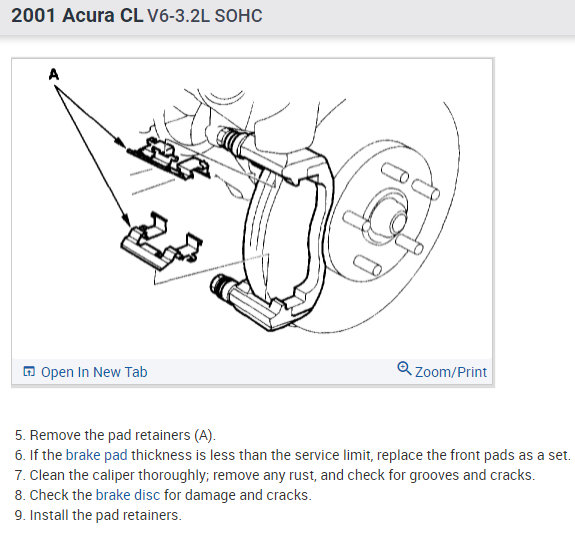

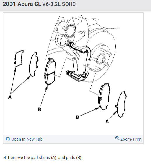

I have attached the replacement procedure for your reference.
