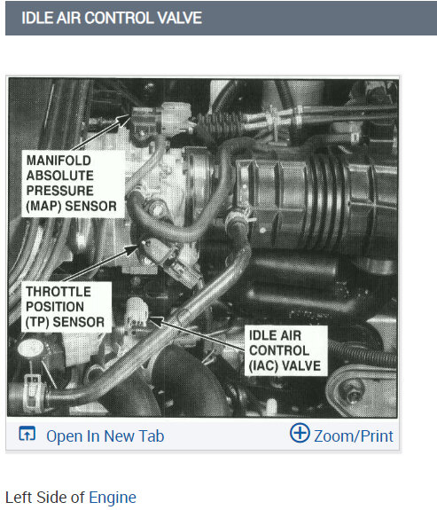

This can happen when the IAC valve needs service, here is the location so you can check it out with a guide to give you step by step instructions.
https://www.2carpros.com/articles/idle-air-control-valve-service
This will need to be removed and cleaned. Check out the images (below). Please let us know what happens.
