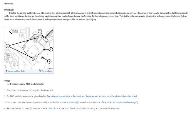

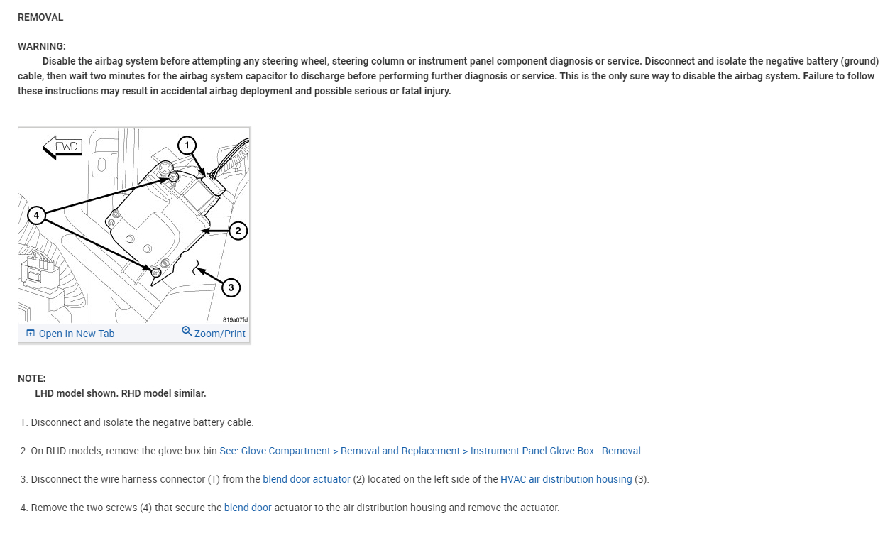

Clicking noise when I put it to a temperature. Are there three actuators? can’t find the third one, I found the two behind the glove box.
Nov 27, 2021 at 7:16 AM
CERTIFIED EXPERT
52,796 POSTS
Good morning.
I attached the procedure and location of the blend door actuator. When you get the clicking when changing temperature, it is the blend door actuator. It is behind the glove box.
