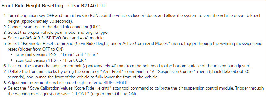

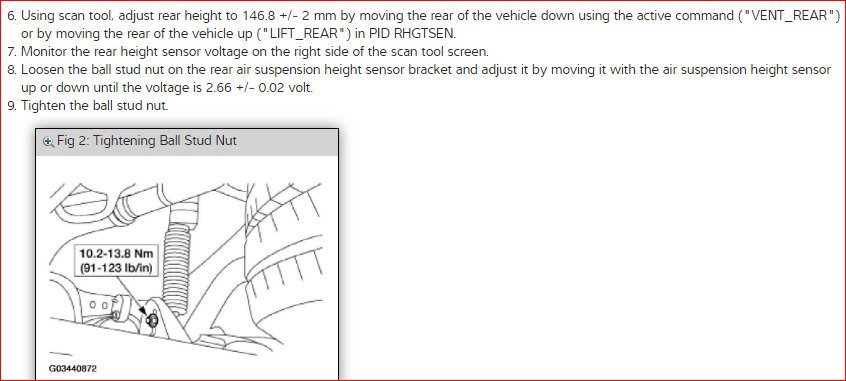

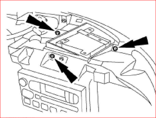

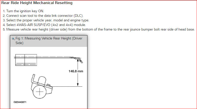

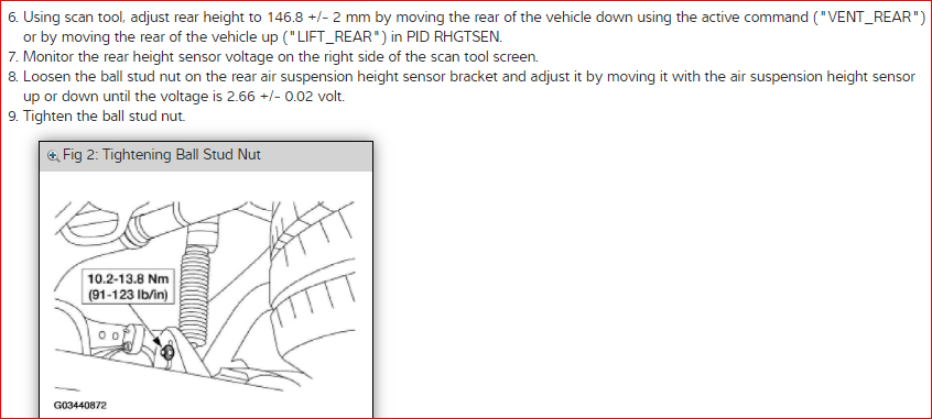

Just a quick question first. With the system being disconnected for awhile did it throw a code B2140? I found that when system is disconnected it tends to throw that code which requires the ride height to be reset with a scan tool. I have attached of picture of step-by-step instructions on how to reset. I have also attached a picture of the module location which is behind right side of instrument cluster. Also attached is a link on how to test the relay. Hope this helps and let me know if you have any further questions. Thanks for using 2CarPros.
