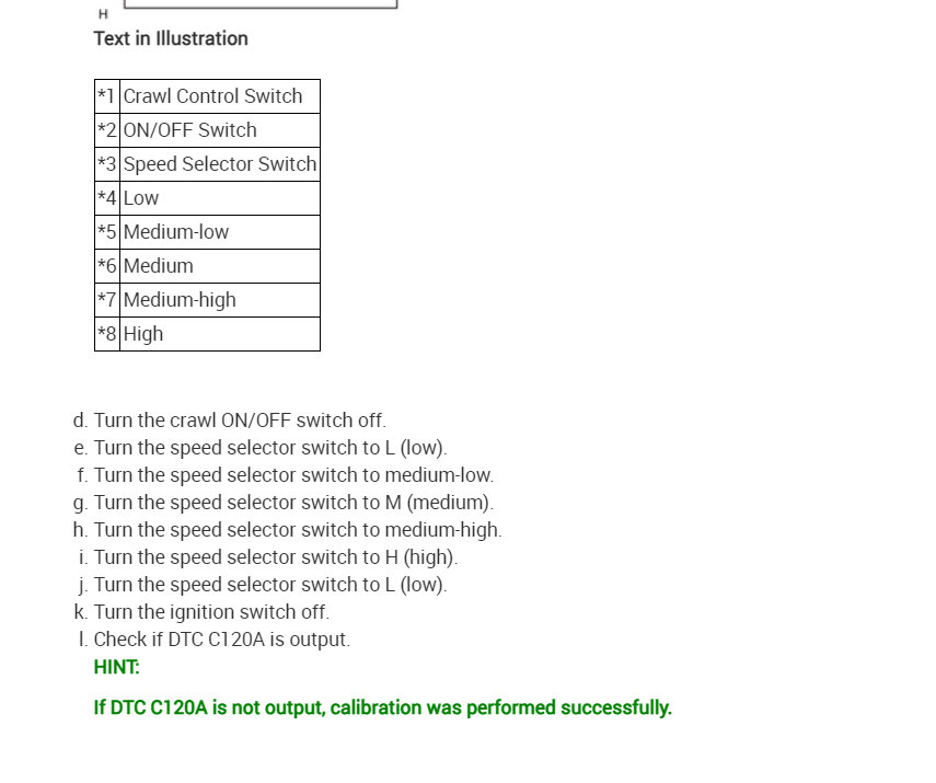

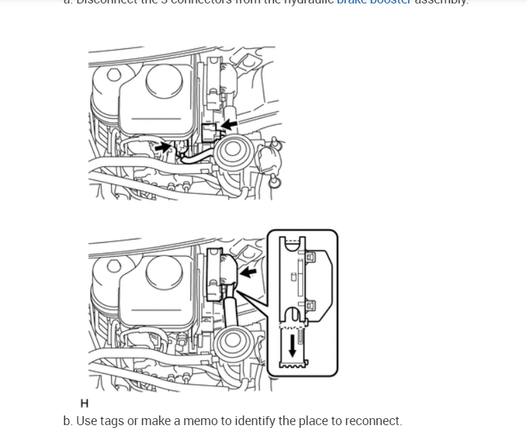

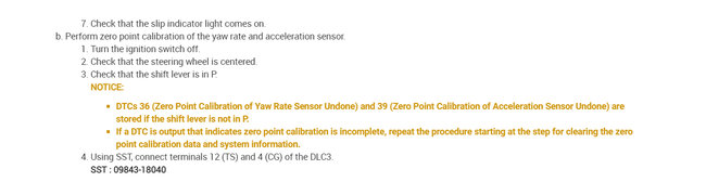

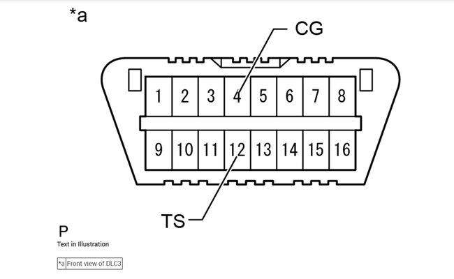

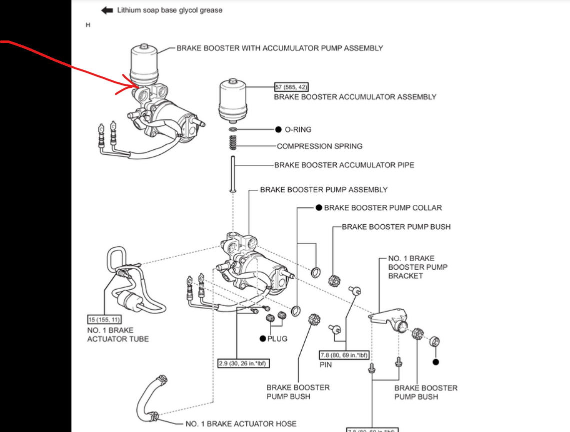

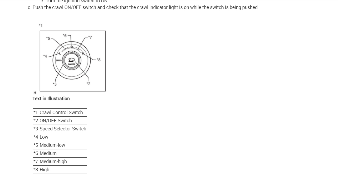

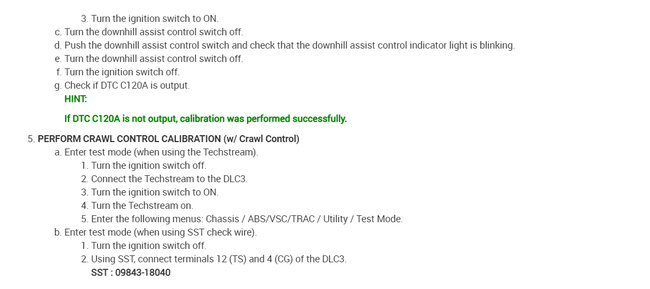

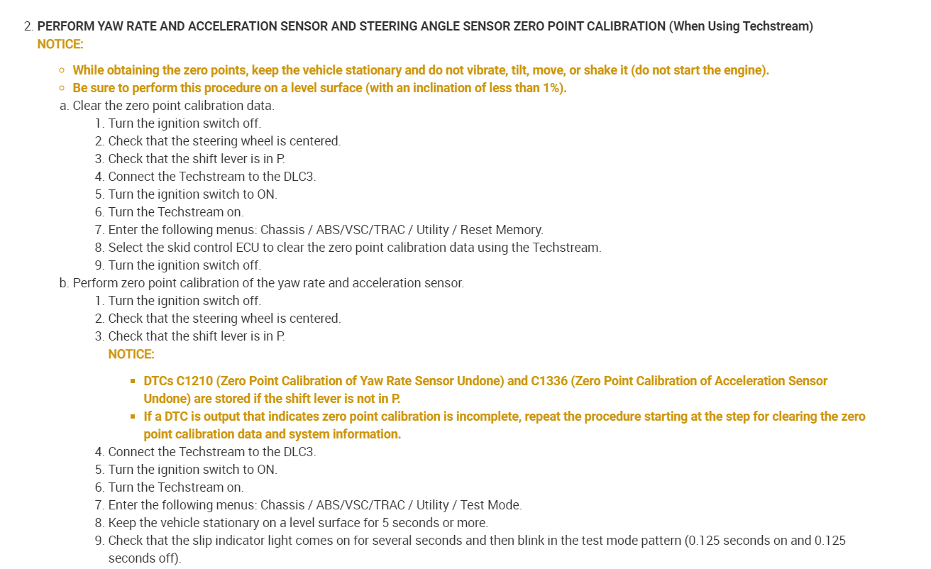

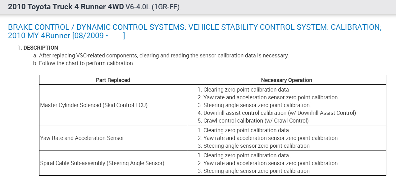

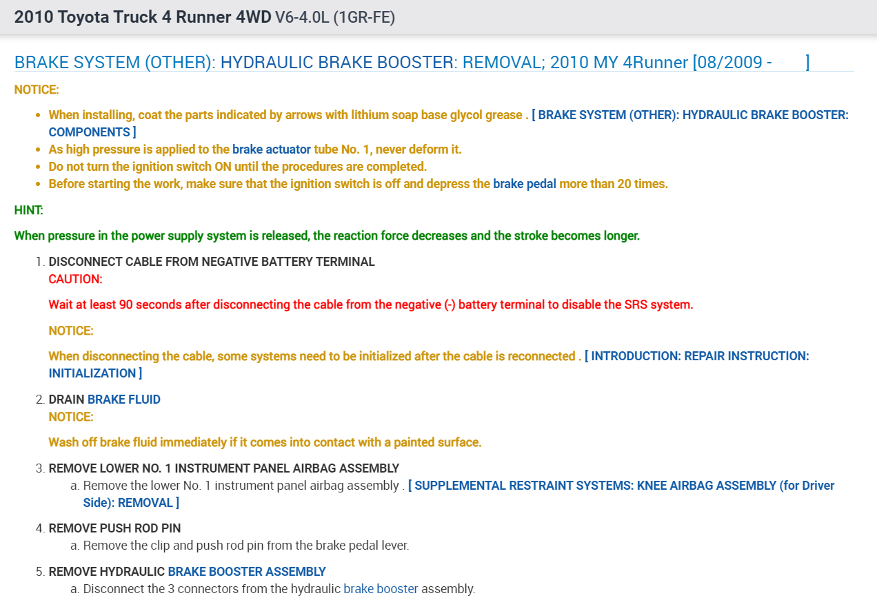

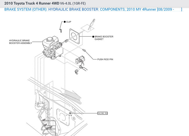

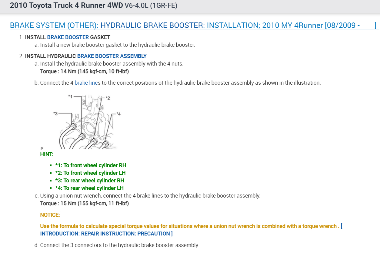

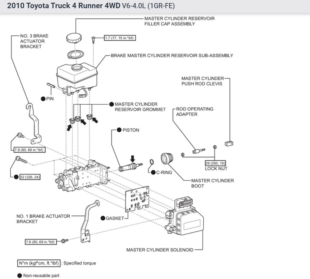

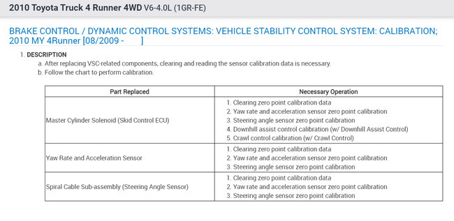

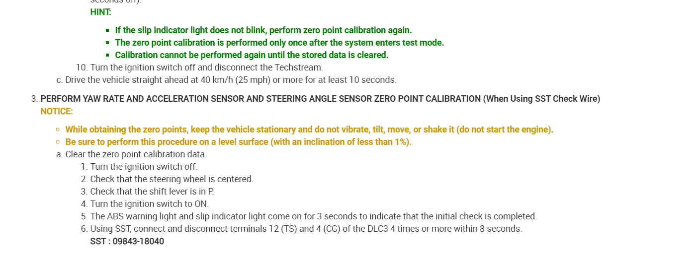

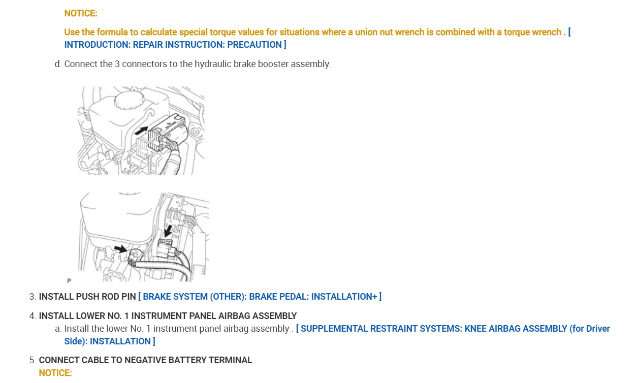

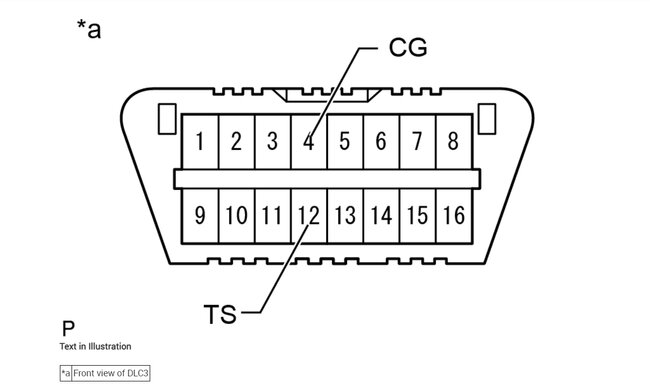

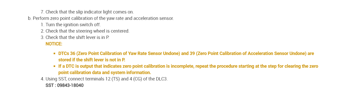

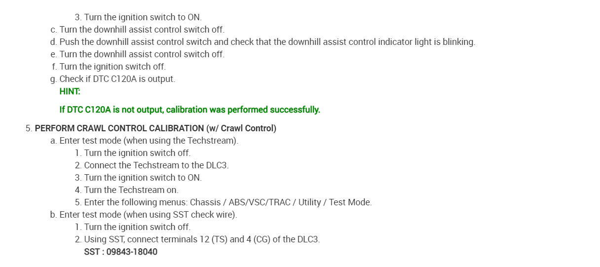

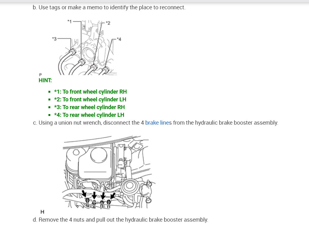

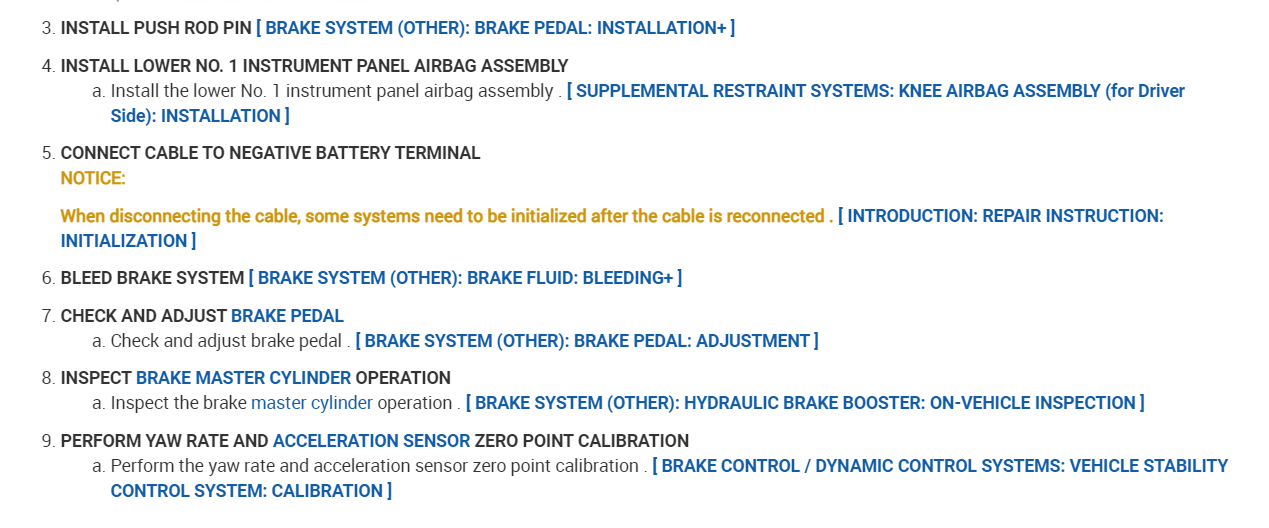

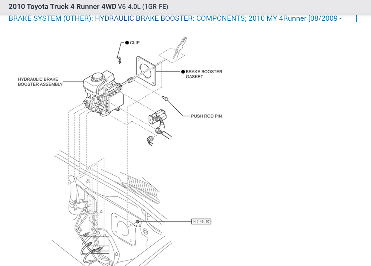

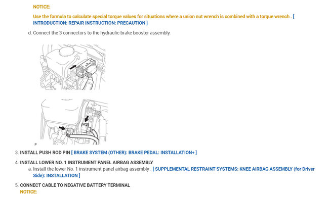

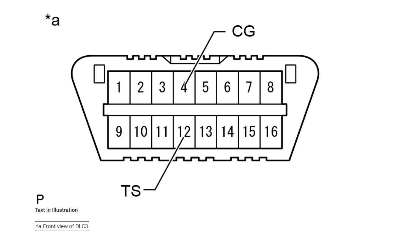

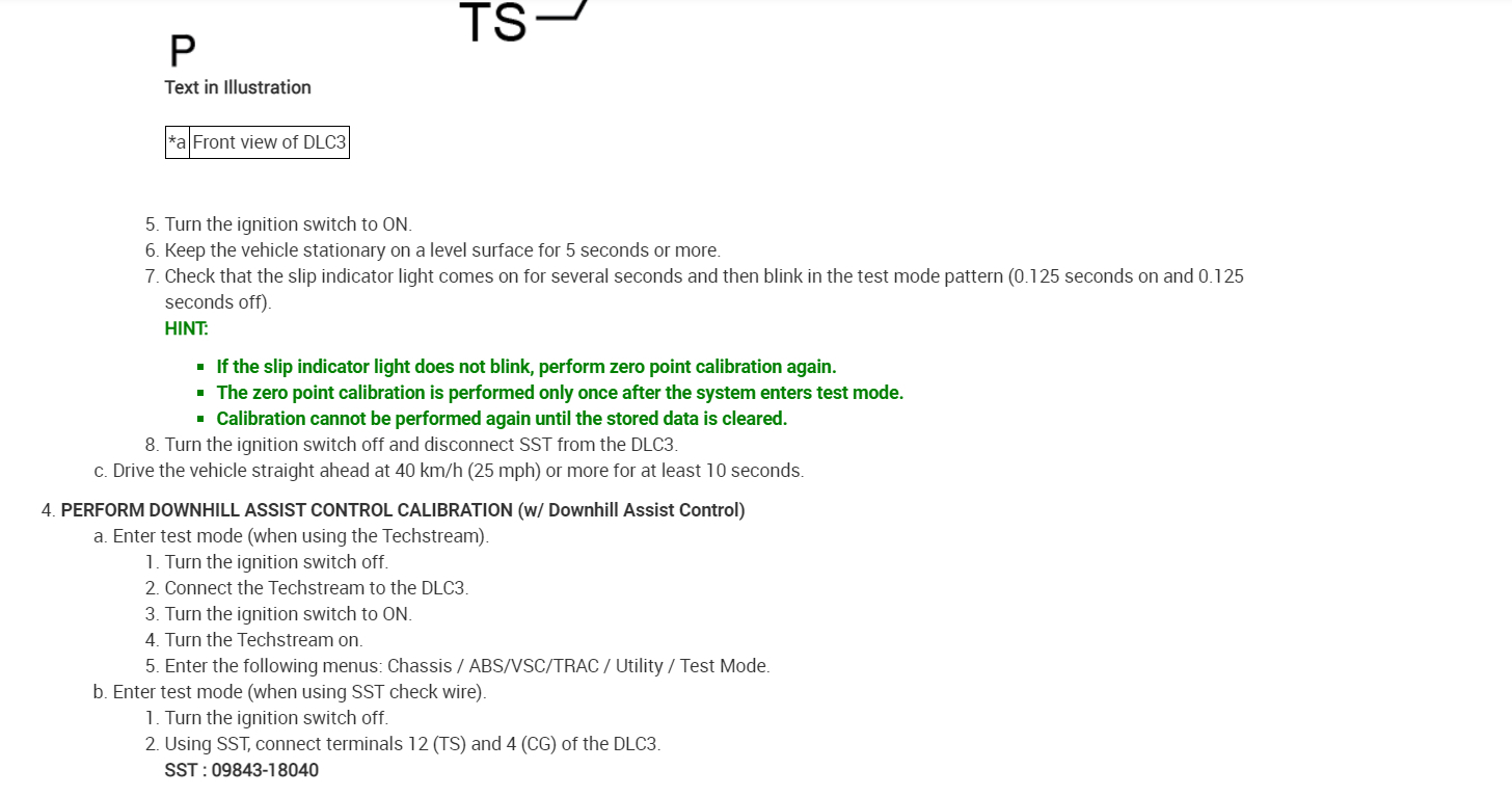

The brake accumulator is responsible for storing pressurized hydraulic fluid that is used to power the brake system's booster. If the accumulator pressure is low, it may indicate a leak or failure in the hydraulic system, or a problem with the accumulator itself. If you do not have any brake fluid leak then the ABS hydraulic unit has gone bad and needs to be replaced, also there is a calibration procedure that must be followed which I have included in the images below. Check out the images (below). Let us know what happens and please upload pictures or videos of the problem so we can see what's going on.
May 6, 2023 at 10:30 AM

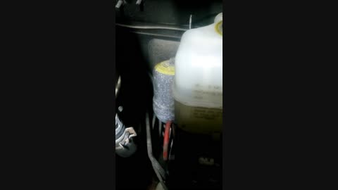

Thanks for the reply, Ken. I was curious if you are suggesting replacing the whole abs hydraulic unit (essentially the master cylinder + solenoids) or if there are any part solutions such as if that seal between the two has failed or something else. Just trying to be cost effective, and not afraid to take it apart and get into the finer details. I've also attached a video with the standard actuation of the accumulator and an actuation with the "grinding" noise that I originally noted. The pressure values I previously recorded are 1.43 V Accumulator and 0.92 V master cylinder , which if I'm not mistaken is low for the accumulator (makes sense if failing sensor), but I just wanted to include as much information as possible. I really appreciate all the help!

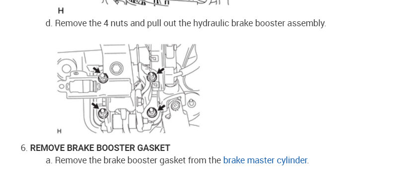

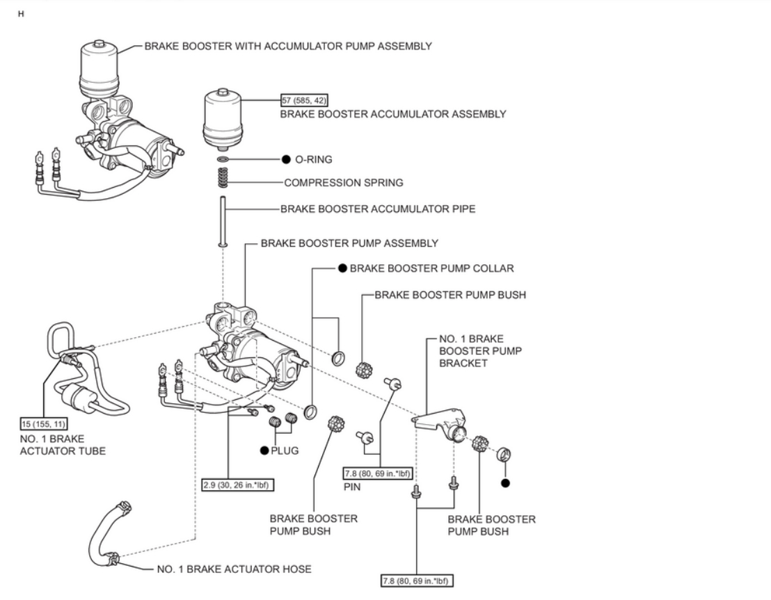

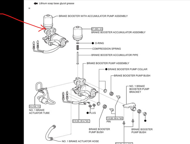

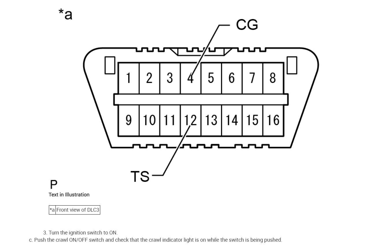

It sounds like the system has low pressure which makes that noise. With those voltage readings it sounds like the accumulator pressure ball bladder has ruptured or the pressure pump is not working correctly. Check out the images (below). Please let us know what you find.
May 7, 2023 at 11:23 AM

Yep, that sounds like the unit needs to be replaced, the accumulator or pump is bad. I would do both.

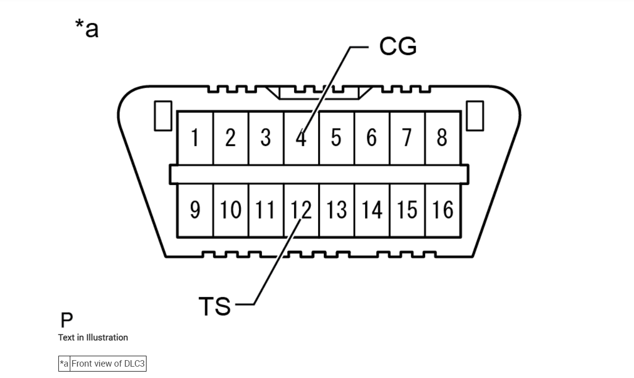

I have seen weak or bad wheel speed sensors cause the ABS to actuate. Do you have the code number from the ABS?
https://www.2carpros.com/articles/anti-lock-system-testing-and-repair-abs

The errors are the same as original, C1252 - Brake booster pump motor on time abnormally long and C1256 - Accumulator pressure low. My thoughts are the sensor is bad and the rest of the system is fine, which if I'm correct would require replacing the master cylinder solenoid box which contains all the electronics.
Jun 2, 2023 at 10:15 AM
Yep that sounds correct, let me know what happens and please upload more images/videos of the job if you can :)

Beach, the common problem on brake systems with accumulators and pumps when they have high mileage is wear and tear.
The accumulator breaks down and can't hold pressure. The ABS pump motor which builds up pressure in the accumulator has bushings that wear down, so those things start to act oddly too.
A new accumulator seems to be around $200. The ABS pump just needs some cleaning and replacing the bushings, but you'll have to push out the bearings to get to the bushings on some models. A new ABS actuator is around $600-$1,000 on Toyotas.
I would just shop around exclusively for an accumulator most similar to the one in your car model and just replace that. You just simply twist it off.
